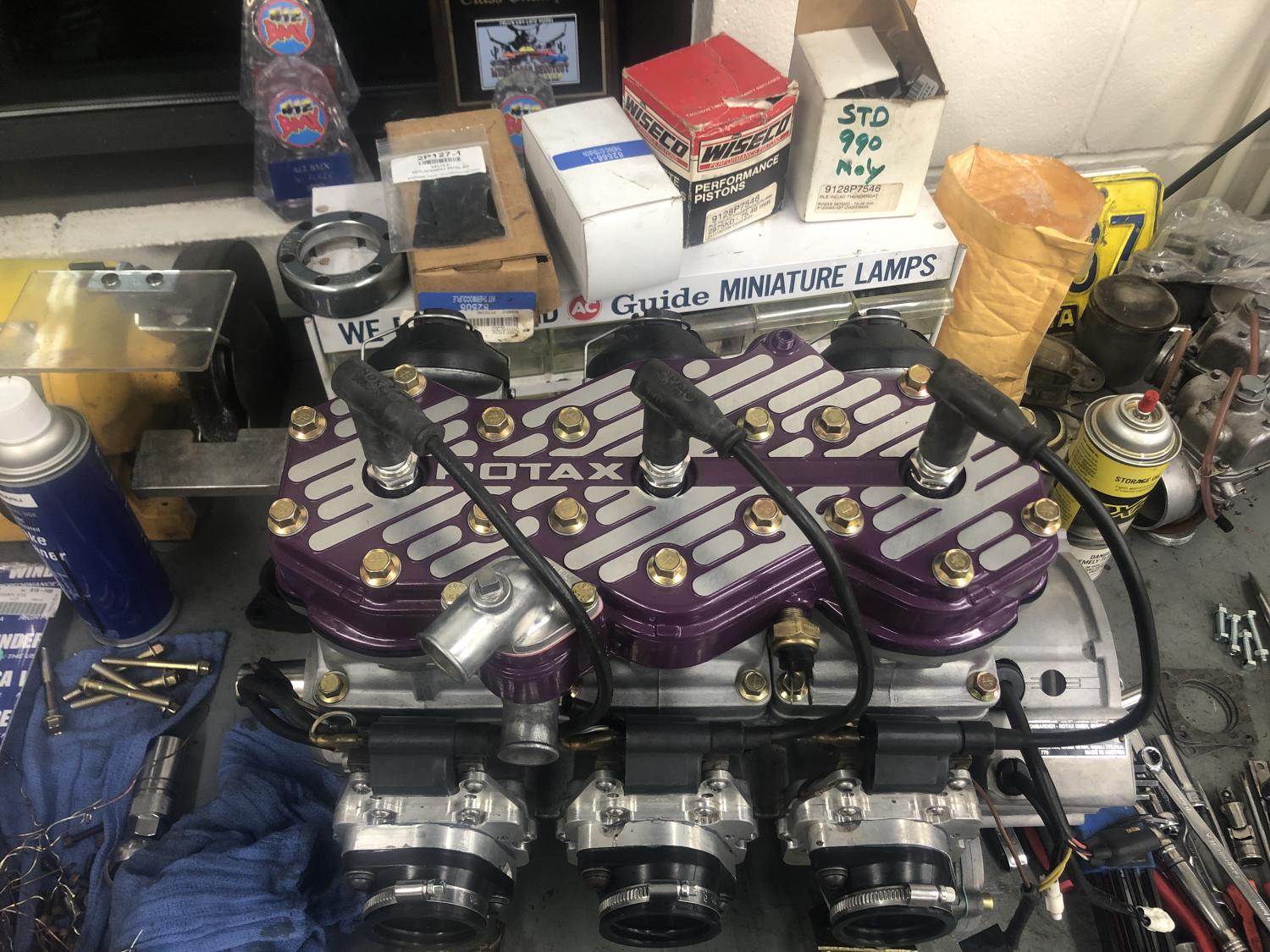

Caswell makes a nice kit. Once you have down the steps you can plate bolts or small parts and make them look professional
I plated the bolts on this snowmobile engine I restored with my caswell kit

That’s awesome! This engine is a russ lemke 990. I love the mach z’s. When I’m not playing with Camaro’s I’m working on triple ski doos
