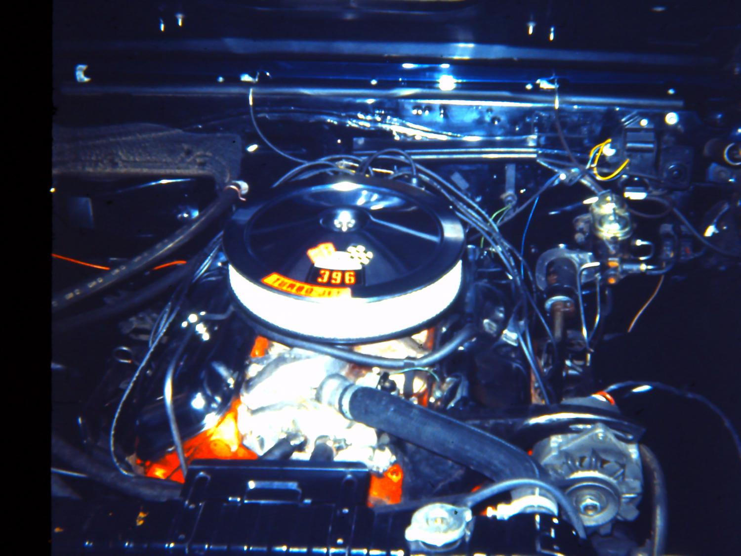

Thanks for the info so far guys! I've attached a pic of my '67 Chevelle L78 engine when practically new (you can tell the firewall is nice and fresh!). Note the alternator.....this appears to be a standard pulley arrangement. Either some L78's came out of the KC plant with non deep pulley alternators, or someone on the engine assembly line in Tonawanda screwed up!
I had problems with my power steering belt going off under hard acceleration [i.e. drag racing! :-)], and I've often wondered if the power steering pump also didn't have a deep pulley. This will always be a mystery to me. The crank pulley no doubt was the 3 groove deep pulley arrangement (the car had no smog & no A/C of course).
I thought I'd ask this question on this forum, since there were probably more L78 Camaros in '67 than Chevelles. Just looking for answers.
I am building an L78 engine to as close as my original engine's specs as I can get.

Far fewer 67 L78 Chevelles than Camaros. I think the Chevelle # is in the 600’s, not certain.

Jon Mello had a 67 Z survivor with around 11k miles that had a standard alt pulley on it with a heavy duty alt. He thinks they didnt have a heavy duty alt. with a deep groove pulley at the time the car was built so they just used what they had. Do you recall your orig chevelle having a heavy duty alt. option ?

No, I don’t believe it did or it would have been listed as an option on my order form & the window sticker, which I have. That’s interesting though! After all these years finding this out intrigues me. Times were much different back then & I suppose mistakes happened on the car assembly line!
