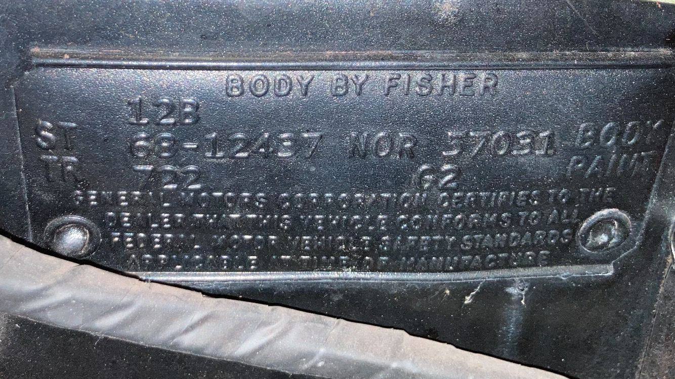

Friend's brother has this 1968 that came with cowl induction from the factory. He asked me if there's any way to know if it's a Z. I know on some data plates there may be hints, but I don't think this one has anything....correct?

Unfortunately, zero info of that sort on 1968 trim tags.

Also, cowl induction not available in 1968 unless you are referring to a cowl plenum. As already stated, no info on a 1968 data plate.

look at spare tire sticker in glove box, if it calls out 15 inch tire size...you know the glove box is for a Z
