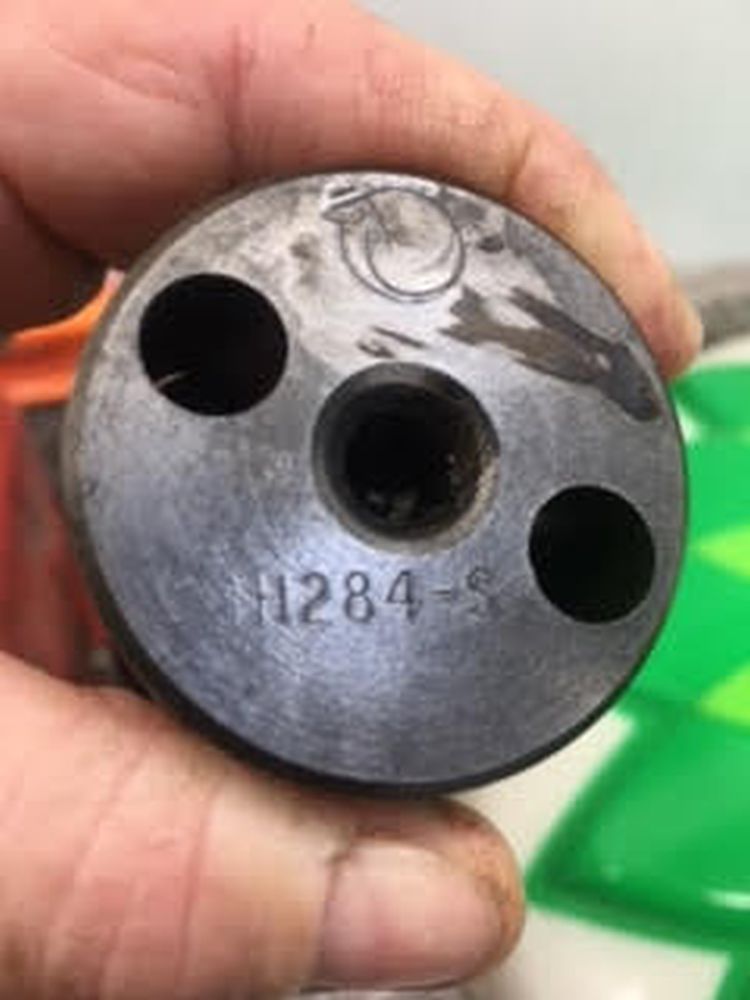

Can anyone tell me what this cam is?
thanks

Is it a Comp Cams Hydraulic 284 Dur. ? I've run that cam in the past and that looks familiar

Could be a Comp 284 Solid cam, specs:
Mechanical Flat Tappet - Lift 0.597 / 0.606 in - Duration 284 / 293 , 258/264 @ .050"- 107 LSA - 3300 / 7300 RPM
This would be a little much for the street.

Isky used to number cams in a similar way also..might check there.
stock class at a local circle track the popular cam was an Isky 280H,which was hyd and about 500 lift.
its worth a shot.

Do you have a shortblock to throw it in? I would degree it just to be safe.

Is it new? Can you put it in the Tony pile? A friend of mine has a Cam Doctor...I can run it for you.

It is not new, but it is in nice shape and I do have the lifters also. And yes I kept the lifter is the correct order.

DEFINITELY A General Kinetics Cam logo
