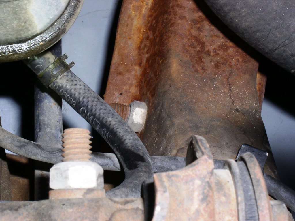

This is the hose from tank to line on Stefanos 69 Z survivor

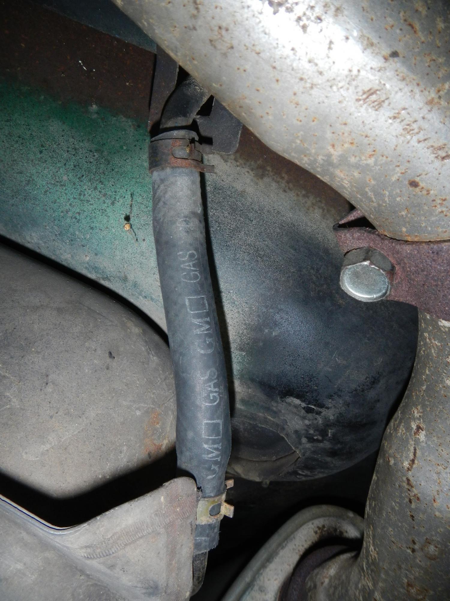

This fuel hose is on a 05A Camaro...Joe
