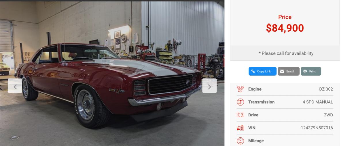

Anyone know anything about this 69 Z/28 RS ? Anyone seen it in person? Is this car worth checking out? Thoughts ??

Wrong stripe color [should be black] should have 1st design rear spoiler and early headrests, ducted hood was added, missing Camaro emblem on upper grille panel. Front fenders fit poorly.
Headers, muffler shop exhaust, missing AIR system, aftermarket suspension mods, repro booster, incorrect alternator. Should not have trunk mat. Several painted or incorrect fasteners.
Not convinced that is the original engine. Never seen an early car [Sept ‘68] with the VIN stamp on the side. Pad needs to have paint removed. Like to see a better pic but window sticker looks real.

That's quite a list for the money their asking....Joe

I think you caught most of it

Hey Guys, Thanks for all the info. I don't think this is the car for me...I'll keep searching......Looking like it will be spring....Thanks again....

are the Docs real?

Window sticker probably is. Protect-O-Plates can be perfectly duplicated so I don't give them much credence these days.

Subject VIN 124379N507016

So if the window sticker is real which it looks real to me as well, that would confirm it's an original Z correct?

It would confirm that 124379N507016 was configured as a Z/28. How much of it remains needs to be determined.
