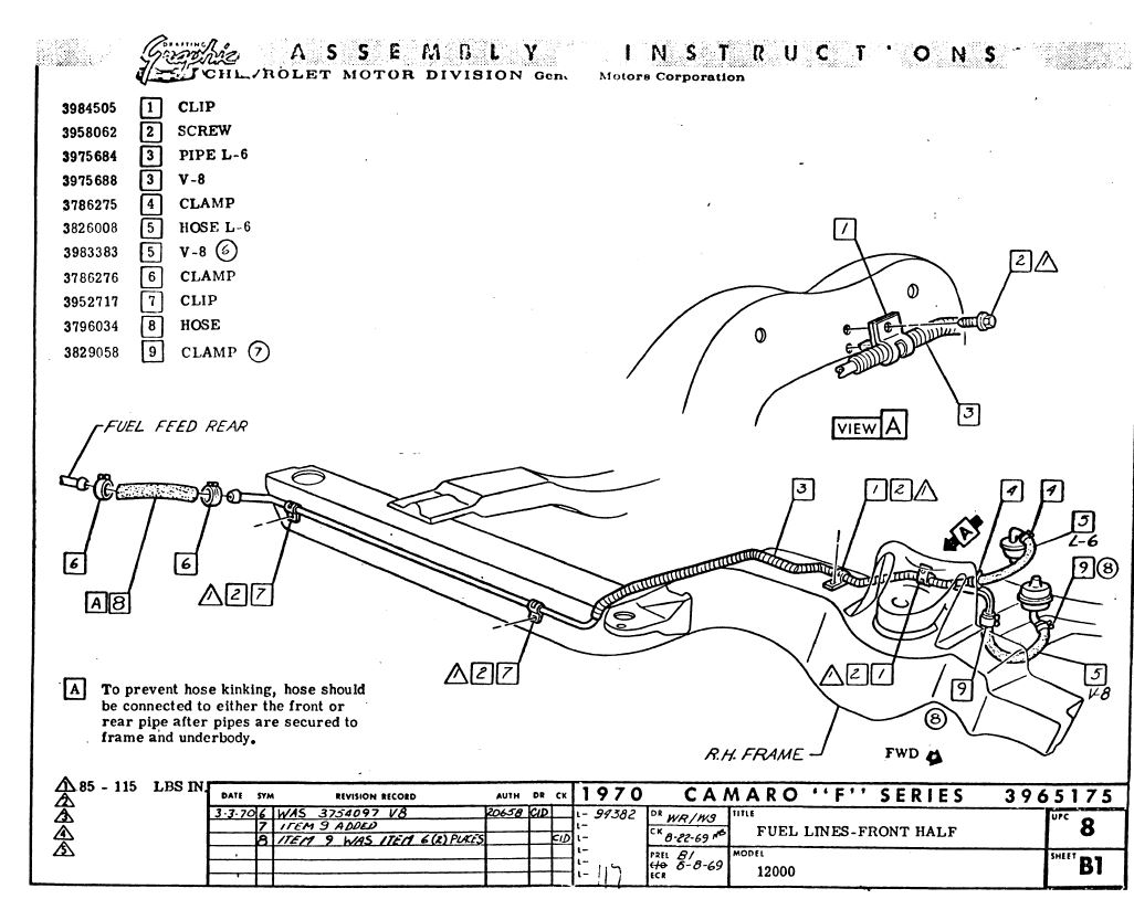

Unmolested ?? What is this about ? Looks like the front clip and subframe have been off.
L48 TH350
How so? Due to the fuel lines? That was the way they did it due I think to the subframe being rubber mounted they wanted a flex point.

Not that I've ever seen. Correct resto parts are all 1 piece...
https://www.classicindustries.com/pr...s/fgl7001.html

My 78 has 3 points where rubber lines are used. 4 if you count by the fuel pump. Never saw all one pc. Of all places, classic has the most wrong stuff.

From the AIM....in the Classic Industries listing, that is actually the front and rear lines with the rubber hose missing. The L78's and Z28's had a single line. The photo of the car for sale is not a Z28 or L-78 so it got a return line also. By the way, the eBay listing has been ended early. Maybe he got upset that there was too much discussion about the fuel lines?
