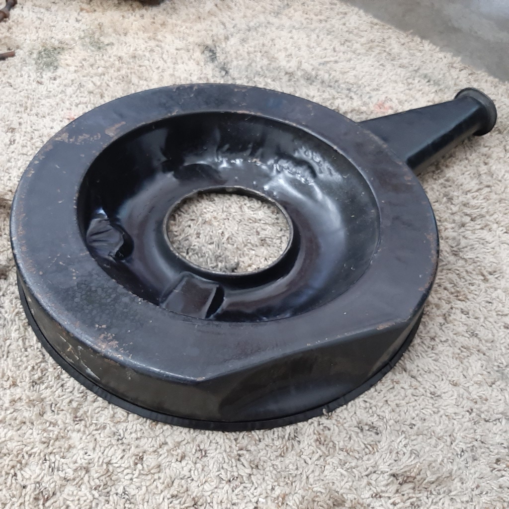

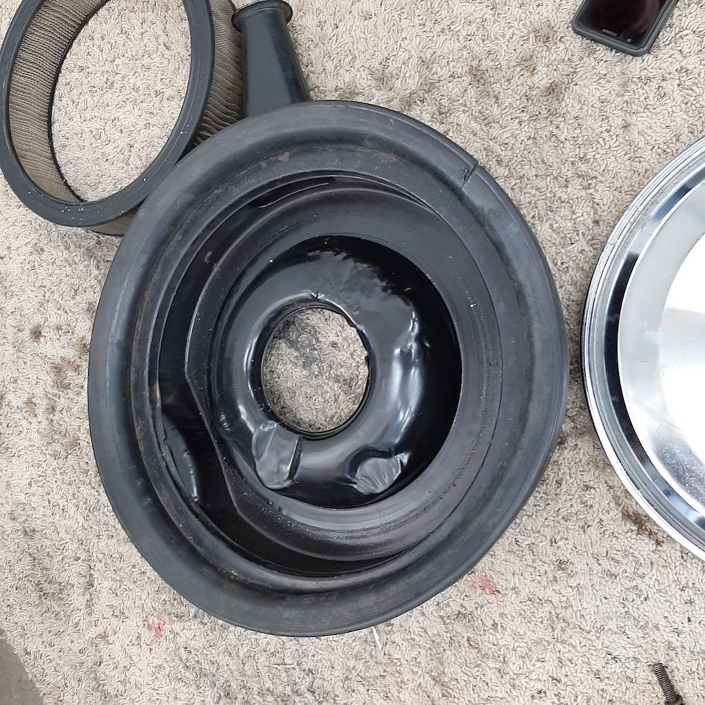

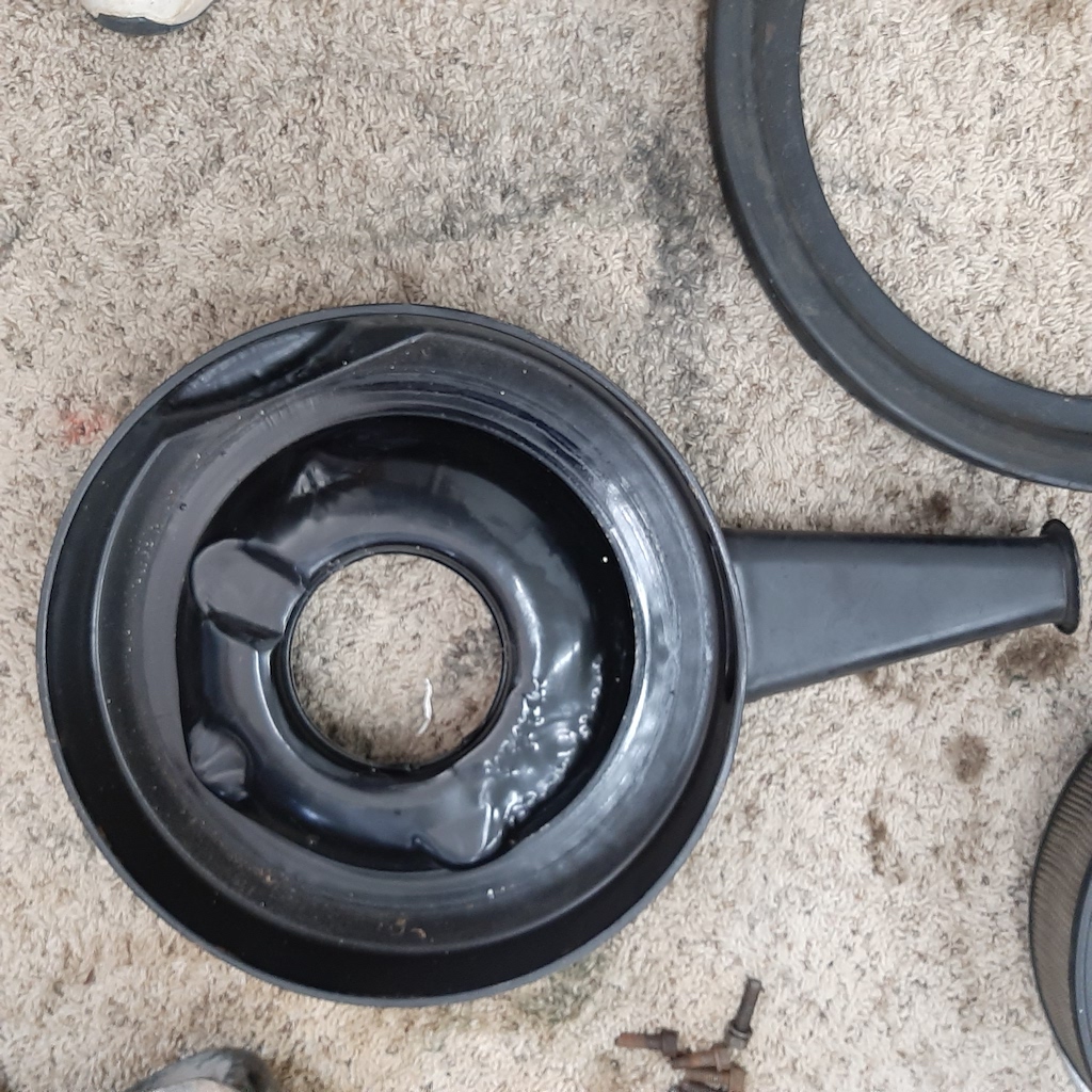

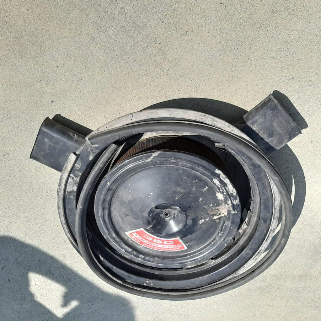

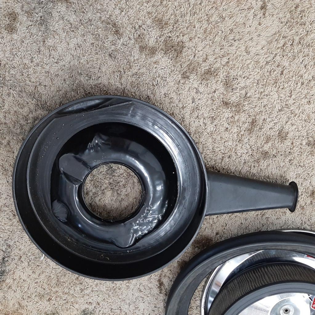

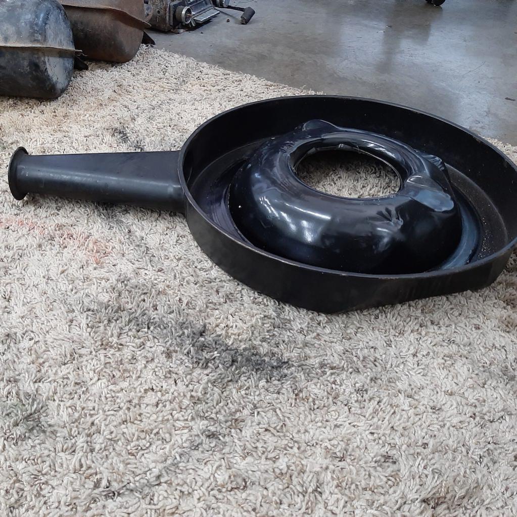

A friend brought these over to help ID. I had never seen a dual snorkel like this with cowl induction. Any ideas? The flange in unique to me with the tabs.
I thought the second one was a big block air cleaner base with a cowl induction ring added. Your thoughts?

The dual snorkel is mid 70s Corvette.
Jason
Yeah, for a Quadrajet application. No clearance bumps for the float adjustment screws on a Holley.
https://www.corvetteforum.com/forums...3-img_0103.jpg

The single snorkel with the flat bottom might be 1966ish 396.
