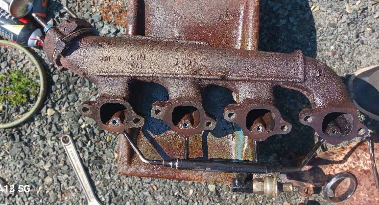

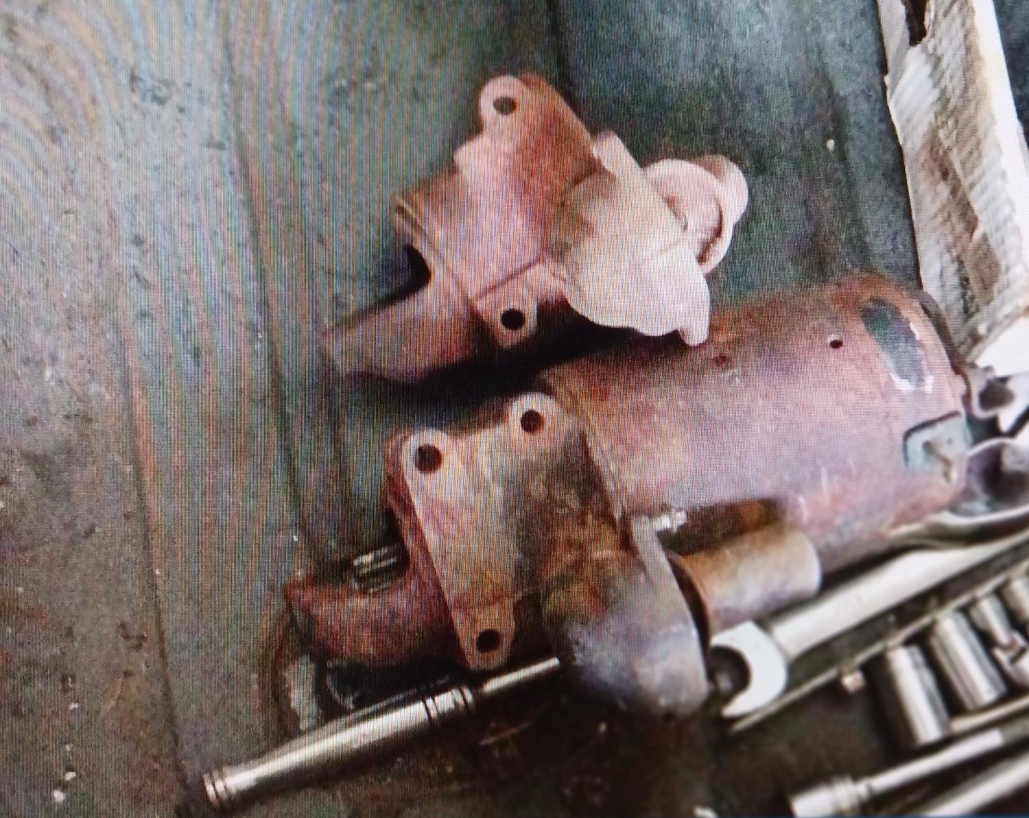

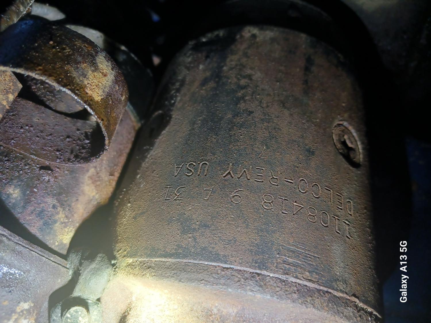

Not exactly what you seek but this is on a third week of Feb Baltimore L78 M22 Chevelle.
Cast nose and motor brush painted Lemans Blue with a brush.
Couple views of the afore mentioned shield.
Tube nut for solenoid attaching point is in console.
Twisted off stud is why the starter- head shield had a photo- op.
