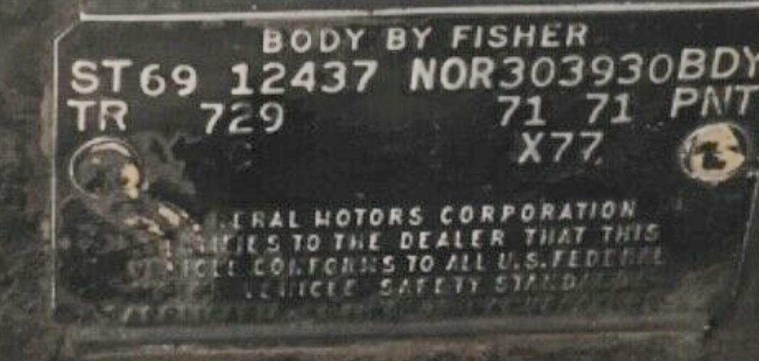

is there an assembly date on that trim tag? I sure dont see one
Third week of something...

I would Guess 04C date
