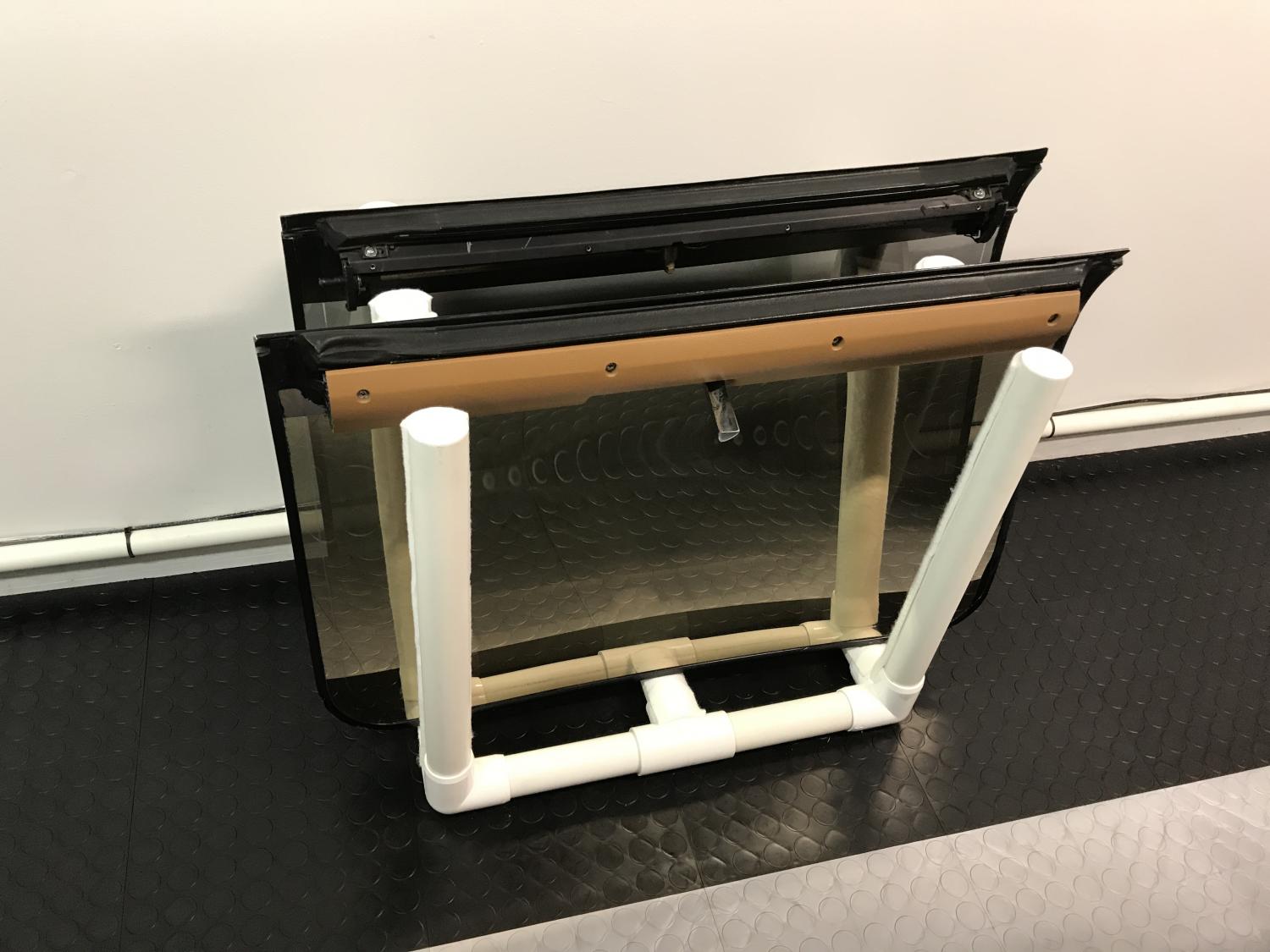

There’s no place to put your T Tops when you take them off, the trim gets cracked in the trunk, and the trim is around $200 for a set these days. And you have to paint the trim too.
On line there is a furniture grade PVC fitting, who makes furniture from PVC, They even make a smooth low profile cap, you can place the top in with the handle in the open position, it’s all padded, I put white felt on the area that touches, pm me if you want the count of what you need to make one. It was all about $50. You may have to adjust the size for Vette t tops,
