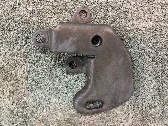

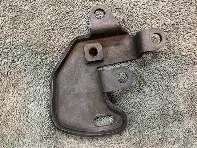

This piece received a bath in evaporust, no other treatment. Bare steel or gray phosphate, or other? My money is on phosphate....what say the experts?

I have had a few originals, phosphate

The 69 Big Block brackets were gray phosphate.

Thanks guys - gray phosphate it is!
