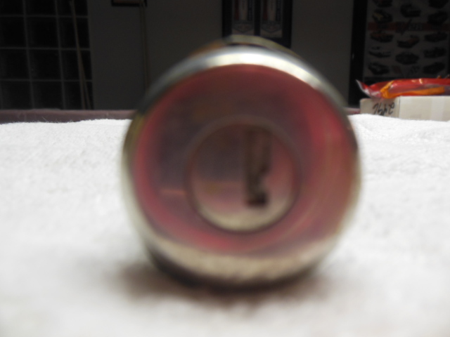

here is a original trunk lock the doors are the same in looks

Posts: 12,350
Bingo!

I’ve rebuilt mine and salvaged the OEM notched flapper and used it with a new cover. PITA to take apart, but the results are perfect.
I agree, pet peeve, straight slots look like ...well they’re just wrong.
