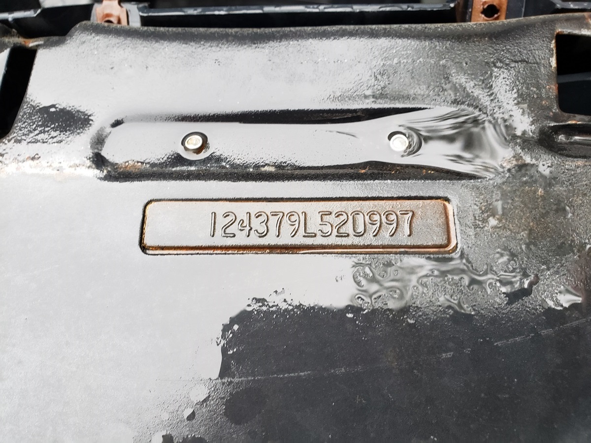

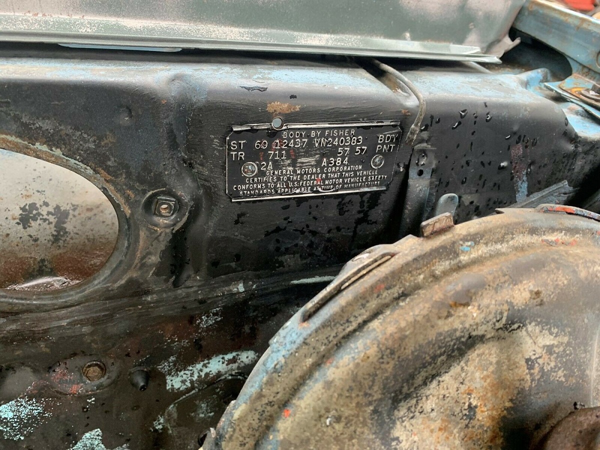

As you know from some of my other posts I am working on a 69 Camaro Van Nuys car. Meaning no x-code. Fathom Green Black standard gut 02A date on trim tag

I am including the vin and data plate so there will never be any confusion on this car being what I say it may or may not be.
