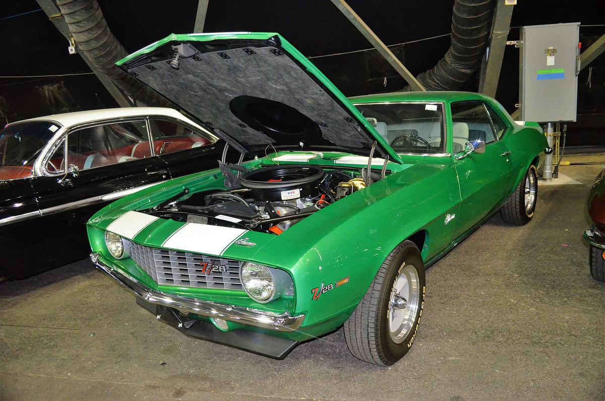

Default 124379N647817 - 69 Z28 Known?
Great looking car. Anybody know anything about this car? This 69 Z28 and I think 9 others are selling on Friday at BJ

Just for my own education, seeing that the stripes extend to the trunk lid does that mean the car was not originally equipped with a rear spoiler?

Correct

Incorrect. Just not painted right.
Spoilers became part of Z/28 equipment as of April, 1969. N647817 was final-assembled on or about May 23rd and would have been built with spoilers.
Gets style points for not having added style trim.

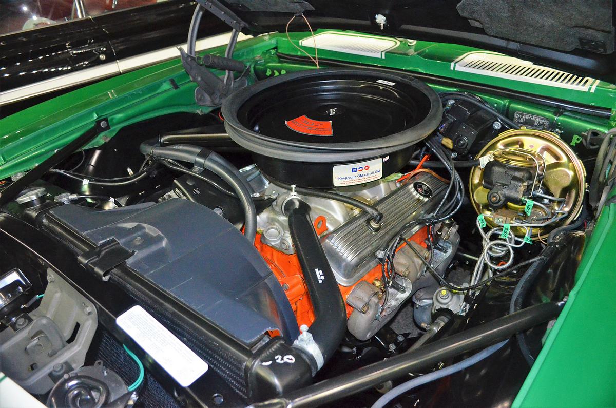

Looks like a reproducion booster, and the valve covers shouldnt be polished.

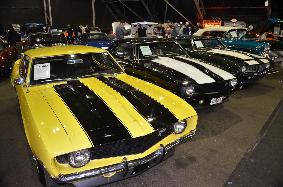

These are the other 2 I am looking at.

Not sure why they didn’t restore the yellow one with the correct black stripe.

Trim tag on the 9N647817 Rallye Green one says 711 black standard, but it has 729 Houndstooth.

Maybe because of the white top
