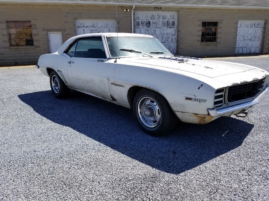

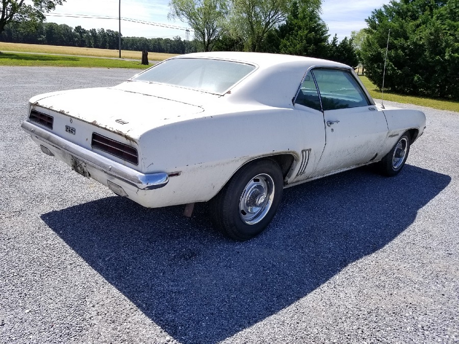

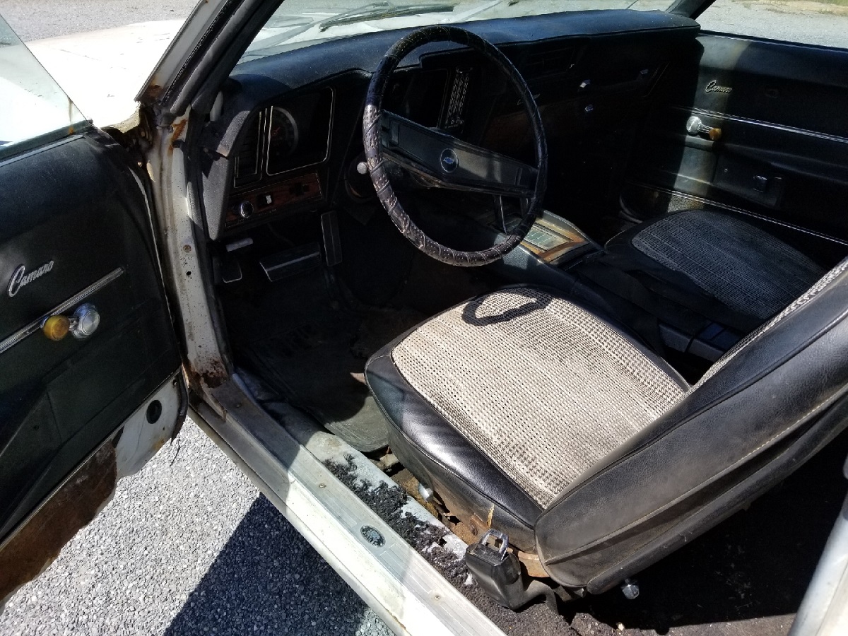

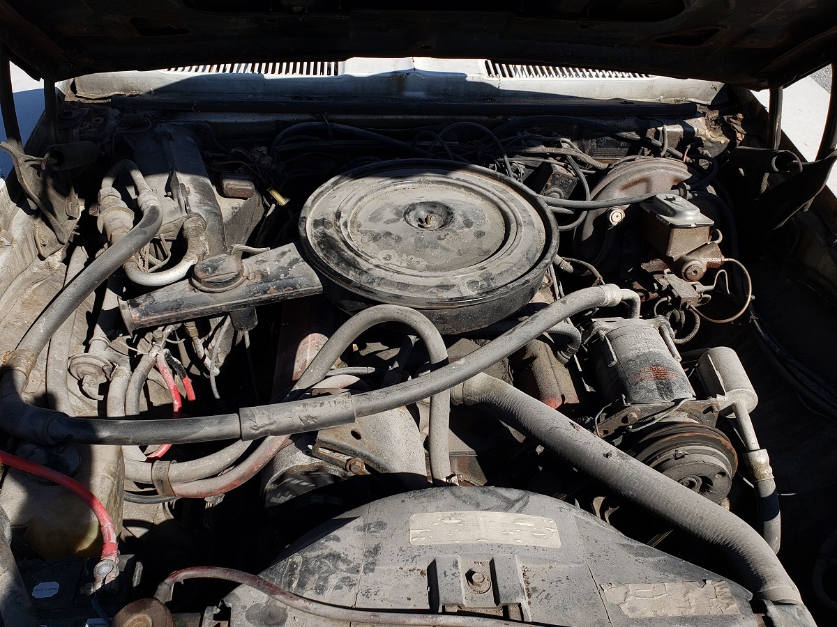

Question for the group. My 69 RS Camaro is currently 100% stock, largely original with about 60k on it. It is not an ultra rare car, other than being unmolested. It has had a poor repaint in original color, some 80’s style rust repair in the wheel houses so she is not a vestal virgin “survivor” but has not been stripped and put back together with wood screws either.
My plan is to make Casper, yes cars name, roadworthy, fully functional and safe. The safe is the question.
Yes a bath is needed in the pictures but that was as found from 30 years in a garage.
The car is a power drum brake car, still all original brake system.
How much of an abomination and violation would it be if I changed to front disc brakes using an OEM specific conversion set up (2 piece rotors, hold off valve etc), as opposed to the metric generic systems out there?
Yes I would be unable to keep the 14 x 6 original rally wheels for drum brakes, but I have already sourced a set of 14 x 6 rally disc brake wheels. Yes I am holding onto the original parts if I make the change.

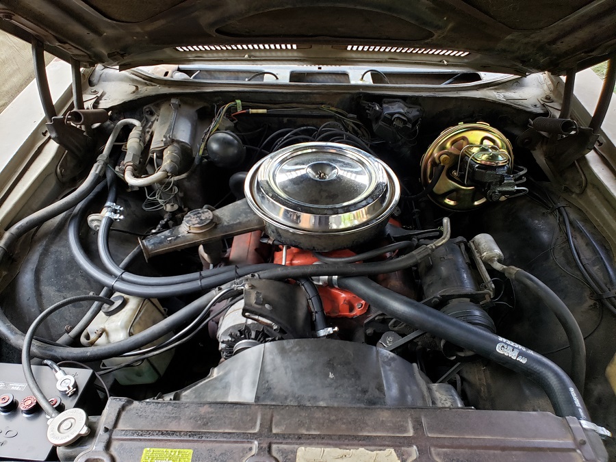

So looks like going to go with the disc conversion.
While i am not going to be driving coast to coast on the super slab if i head anywhere it is traffic light after traffic light so i would be nervous (possibly unrealistically) about brake fade.
This is a pict of the proposed set up that i have installed on the 69 Malibu, yes she too has a name, Barbie, because from CA and a Malibu, and what i hope to have when Casper's engine bay is cleaned up.
