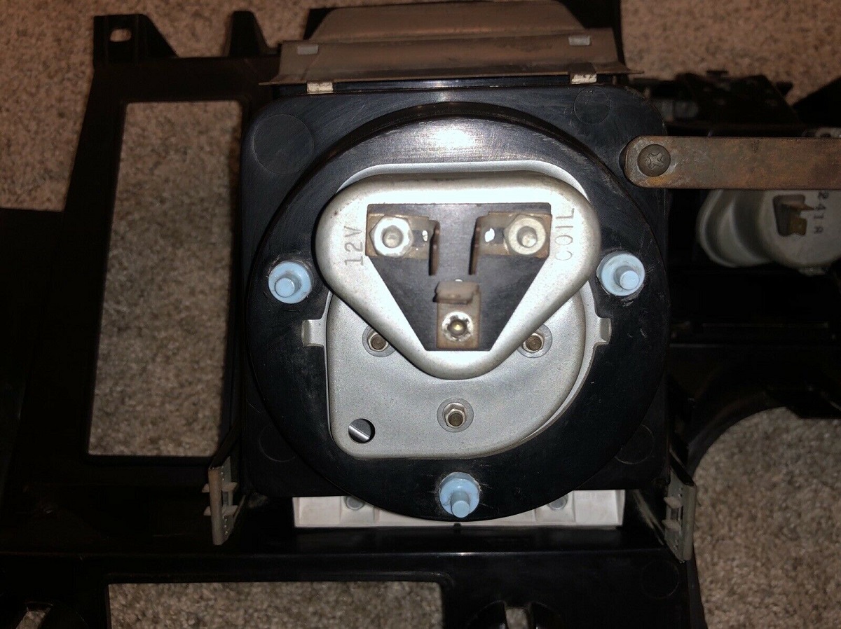

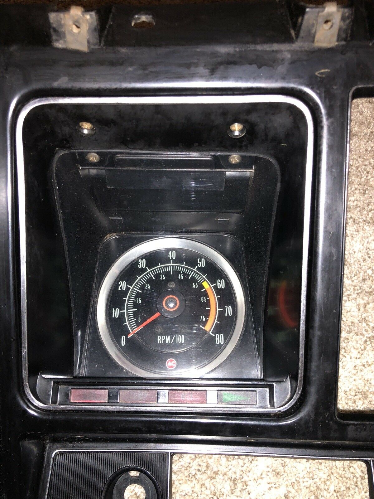

Old 11-18-2019, 05:01 PM
chris slawski chris slawski is offline
Join Date: Mar 2012
Location: New Jersey
Posts: 398
Thanks: 185
Thanked 115 Times in 64 Posts
Default photos
so thoughts?
Old 11-18-2019, 07:58 PM

Old 11-18-2019, 08:09 PM
Join Date: Sep 2001
Location: Santa Cruz, CA
Posts: 6,591
Thanks: 411
Thanked 735 Times in 381 Posts
Looks legit to me.

Old 11-19-2019, 01:09 PM
Join Date: Mar 2012
Posts: 398
Thanks: 185
Thanks folks!
Dave H i am going to wait until later on in the resto to check for the date code. I can just see my ham fists somehow breaking off a stud!
