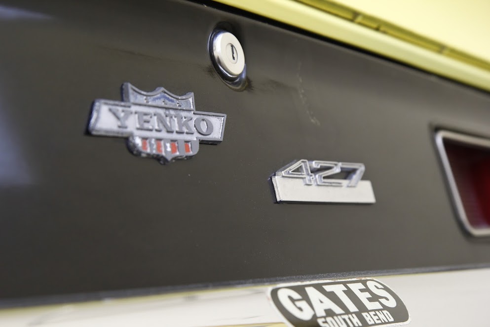

Hi Everyone,
Does anyone have the measurements, or know where I can get a template, for the tail panel Yenko and 427 Emblems? Also for the 427 Hood Emblems?
Thanks!!
Jim

The tail panel emblems use the left original BOWTIE hole for the right side stud of the Yenko emblem and the right side BOWTIE hole for the left 427 emblem stud.
