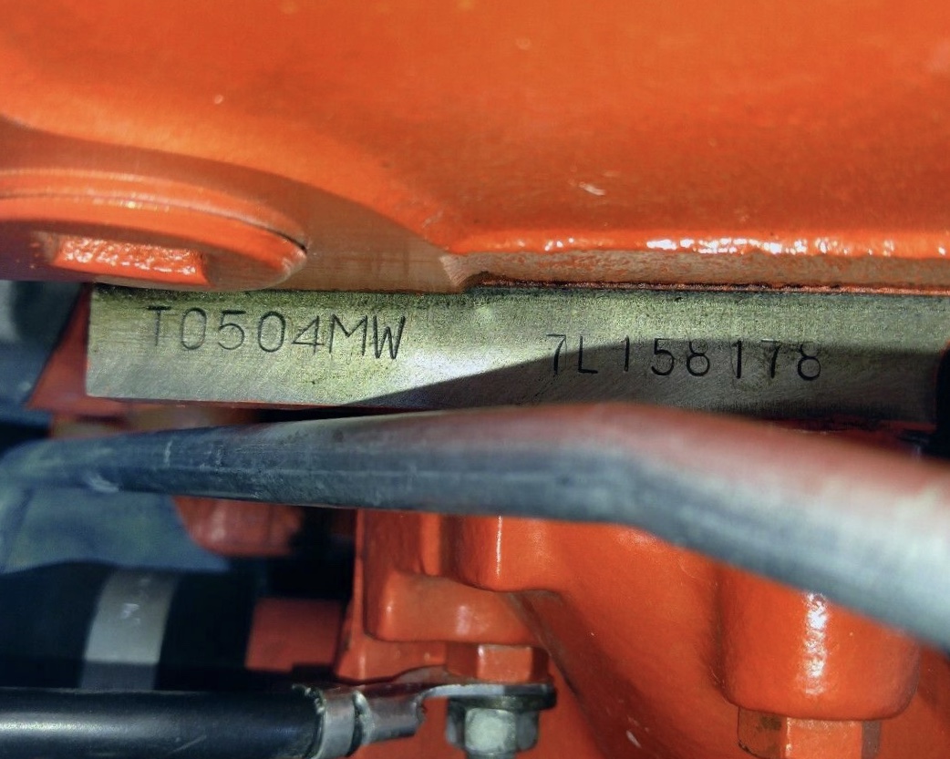

67 SS396 on eBay. Really nice car, but what do you guys think about this block stamping. Looks to have been decked?

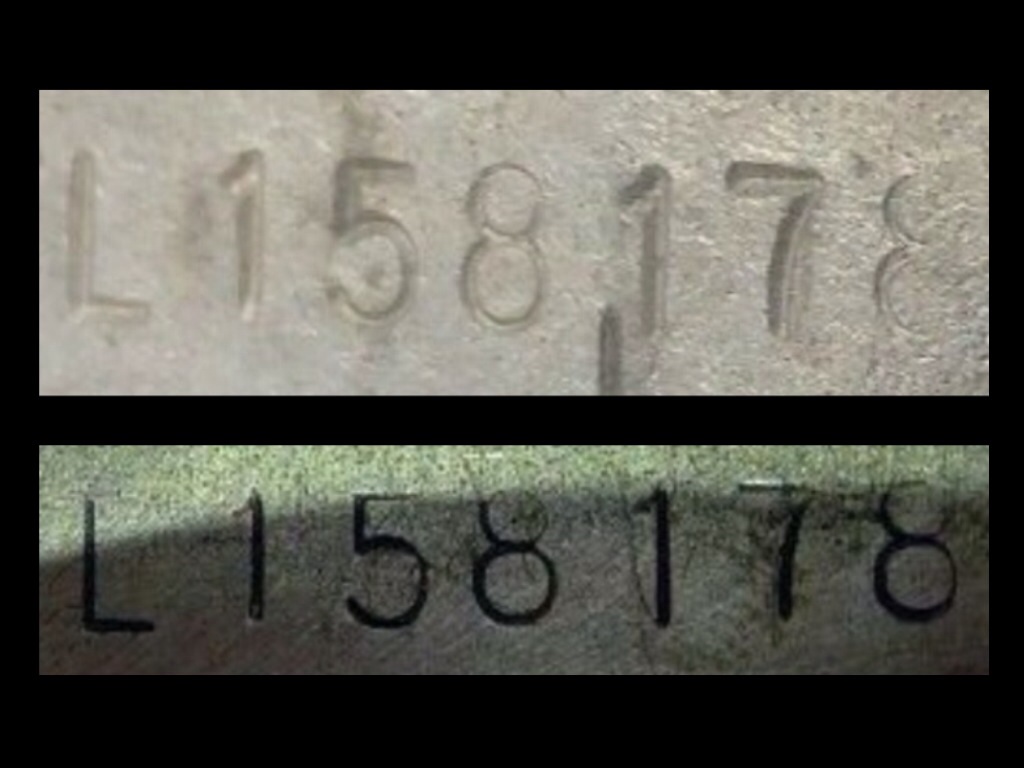

Thanks. My concern is more what appears to be circular machining marks. They are very light, but I swear I see them!

Old 10-26-2019, 06:03 PM
Tarrytown SS427s Tarrytown SS427s is offline
Join Date: Mar 2006
Location: Albany, NY
Posts: 533
Thanks: 8
Thanked 33 Times in 13 Posts
It looks like a restamp to me.

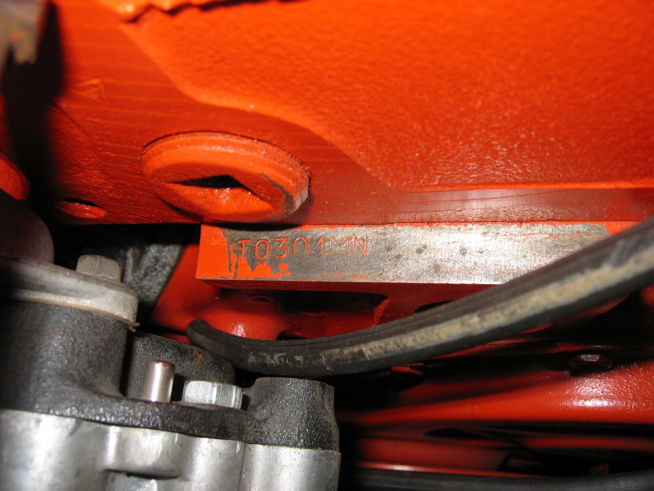

Old 10-27-2019, 12:21 AM
Location: Woodland, ca. US
Posts: 16,051
Thanks: 535
Thanked 4,979 Times in 1,266 Posts
pic I had of a similar date I think.
Old 10-27-2019, 12:31 AM
Zedder's Avatar
Zedder Zedder is offline
Join Date: Sep 2002
Location: Ontario, Canada
Posts: 3,330
Thanks: 100
Thanks Charley!

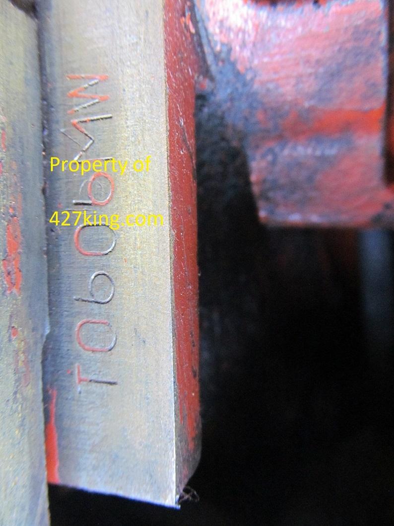

Old 10-27-2019, 04:09 AM
the427king's Avatar
Join Date: Jun 2011
Location: CT
Posts: 7,071
Thanks: 219
Tony heres the pad from the car you found me.

Old 10-27-2019, 04:13 AM
the427king's Avatar
Join Date: Jun 2011
Location: CT
Posts: 7,071
Thanks: 219
Notice how high the center of the W is pointed on mine vs the one at auction.... IMO it is a restamp.
