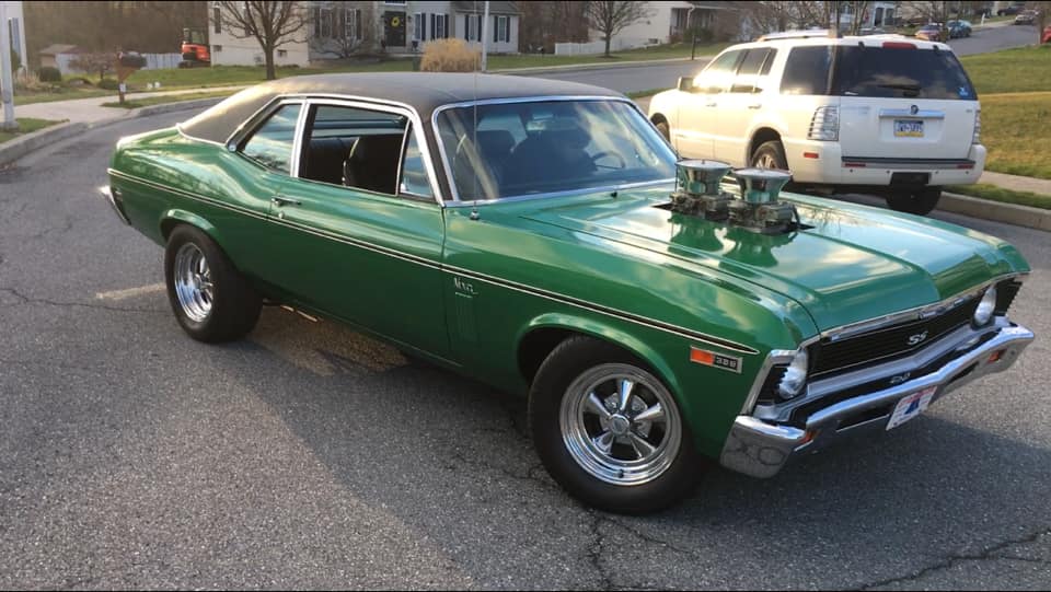

We put a Kee Auto v/t on Ben's Nova, it's excellent....

Did you contact Key maybe they made a mistake? The Nova looks awesome Marlin all the seams are where there supposed to be ?
