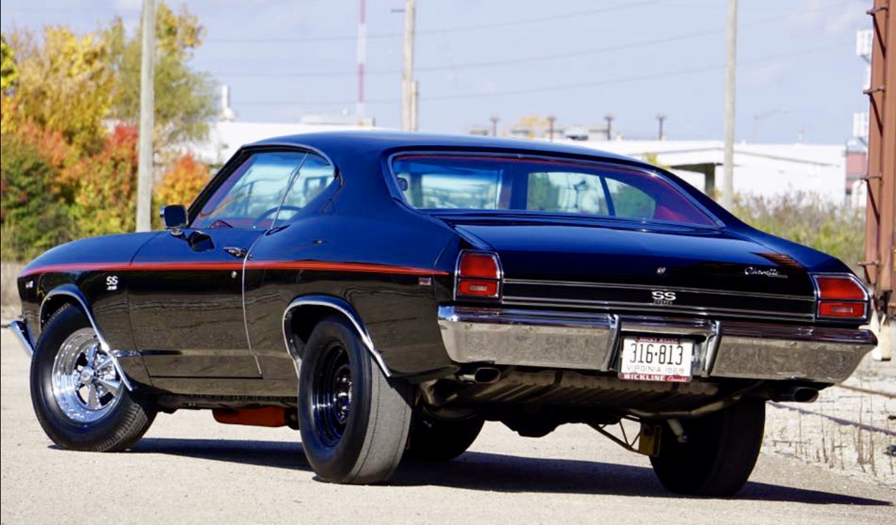

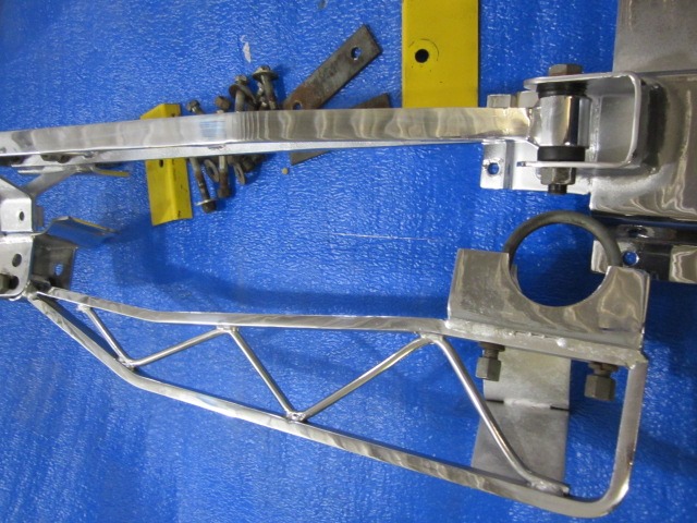

Just bought a pair from a member here for my 69 Chevelle. Can't wait to get them installed. Love the look.

Yea I also love the look. Iv got three sets. A Lakewood set (yellow) a unknown chrome set and an orange set that bolts in place of the lower control arm!

The ones I bought from Gary here on the site bolt up where the lower control arms mount.

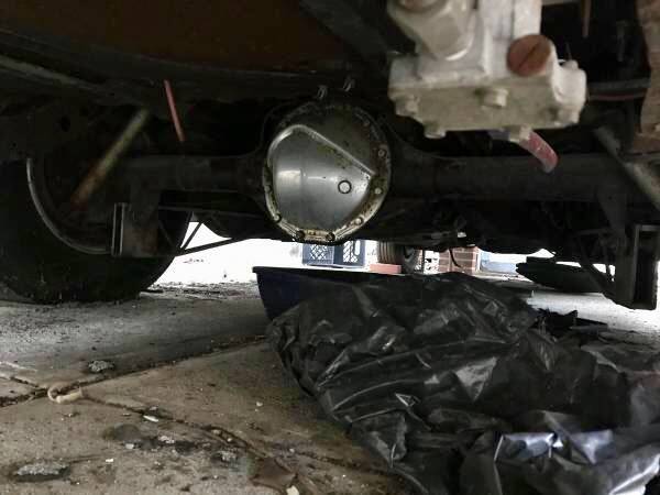

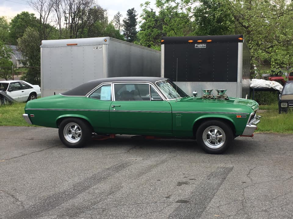

Hey Lawrence, I found a picture of the bars when they were on on that race car!
