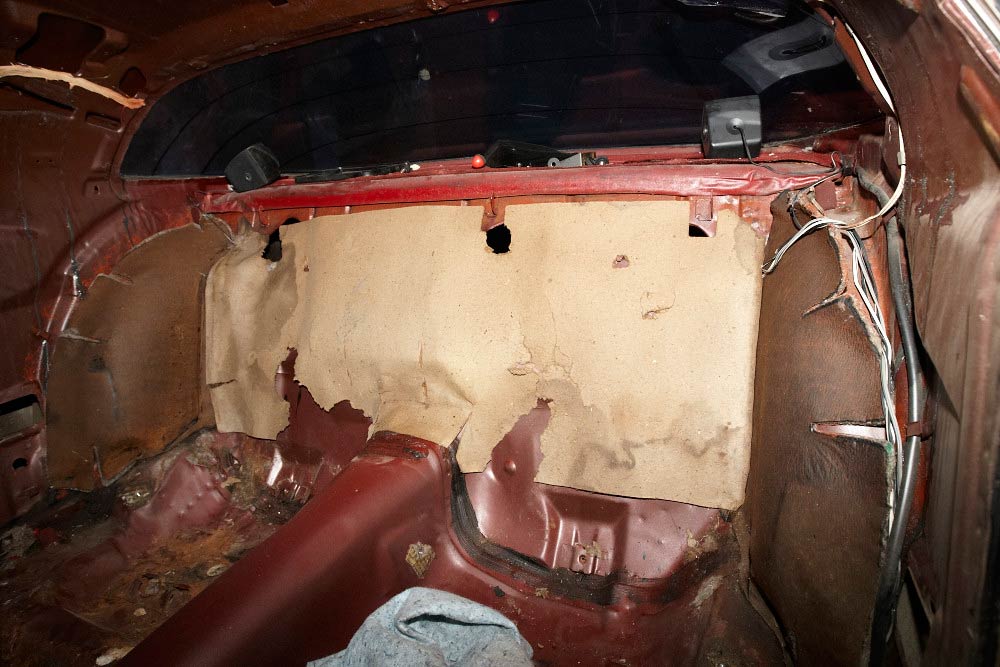

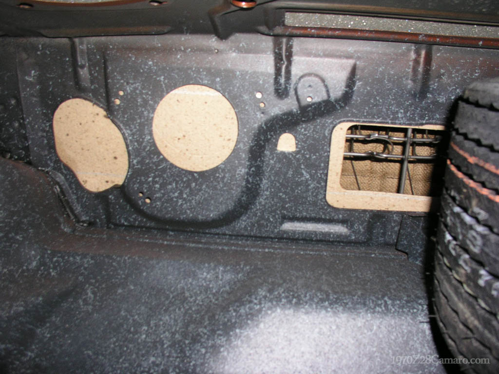

Any good sources for large sheets of material they made into seat/trunk dividers back in the day. From what I've gathered off the internet, the material is referred to as chipboard. Matching pictures indicates its unbleached. Uline sells 40x48 in 0.022" to 0.120" thicknesses, but the cost is in the hundreds. Only need a couple of sheets. Dividers sold by the parts guys have the correct cut, but are made mostly out of solid black cardboard.
Attachments - The Supercar Registry INT_RearDeck_0007a.jpg 1100 mile '70 divider.jpg

I believe REM supplies the black dividers most vendors sell today, but I'll contact them. Do you have any remnants of the original material? If so, knowing the thickness would better communicate with possible suppliers.

Measured my divider...looks to be about 0.090 thick. most likely a nominal of 3/32" originally.
For the insulator, look at the first photo you posted on the inside of the trunk. You can see the foam peeking out around the openings. Apparently it could either be foam or jute. I haven't discovered where or when it transitioned or if it was an either-or thing. My car was a Z87 car and it supposedly had "extra insulation" as part of that option package, but nobody has ever said what that actually is other than the underhood mat and the cowl seals. Maybe the foam was part of that?
An interesting thing I did discover when taking off the foam. There was a round cutout in the middle of the foam at the point close to the rear window. The only thing I can determine is the die to cut the foam was made for the cancelled Vigilite system where there would have been and indicator for the rear lights mounted on the package tray, like the '69's had.

The divider measures 21.5 high by 48 wide, but the 48 includes a 2 inch wide pointed edge for about 2 inches high that honestly you can't see anyway from the trunk. You could get the thickness by getting the 1/32 and 1/16 thicknesses and gluing them together. This is all I have been able to find in single sheet sales that is reasonably priced.
