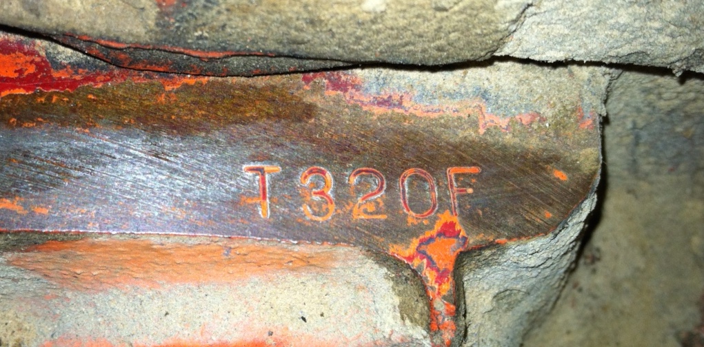

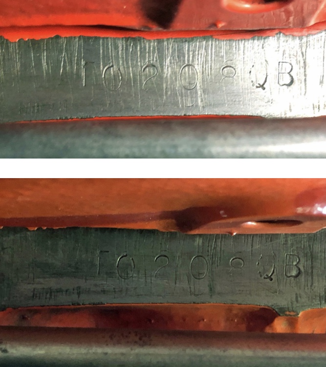

Not sure what to make of the engine stamp, but the trim tag looks real and calls out the factory 4-speed option. Beautiful car for sure, and I believe the claim that there's been $100k+ invested into the restoration.

Looks like someone tried to duplicate the broach marks with a hand scraper or chisel, appears to be restamped too.

That’s the worst attempt at faking broach marks that I’ve seen.

Wow.
What Helmut said.

LOL , reminds me of the bottom section of my old screen door, when we use to own dogs,...all scratched all up from wanting outside ...yea that’s pretty brutal

More Sad is the fact that someone will buy it without knowing any better
