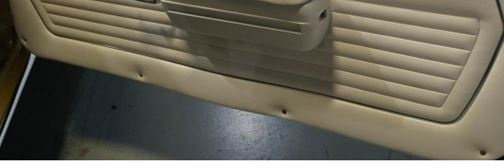

Question for those more experienced than myself: What are visual clues as to the door panels being original or reproduction?

Today's vinyl has a thin layer of foam. The screws along the bottom of a repro std door panel sink into it a bit; looks puffy as seen here.
OE panels had old-school vinyl bonded to the substrate; no foam. The screws don't sink into the panel.

The drivers side looks to have original door panel. The pass appears reproduction. William is the picture you're showing an enlarged picture of passenger panel on this car?

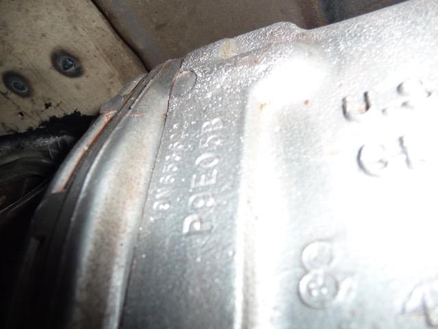

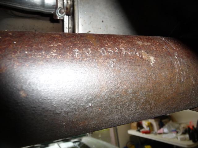

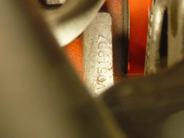

Here are some drivetrain pics i was sent.
