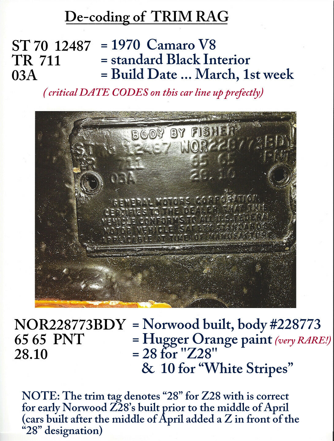

Subject VIN 124870N515506
Below TT pic w/ decode from the eBoy listing, sorry it's so giant sized.
~ Pete

Seller's claim of "all original sheet metal" is not correct...pass fender, at least has been replaced, albeit appears to be GM, and hood hinges do not appear to be original.

98% sure this is my old car. Did not have trunk floor replaced when I owned it. But did have very minor pin holes. I painted this car myself. Always took first place at every show entered. Buried white stripes under the clear coat.
Car was not a RS originally. I changed it. As you can see there are no chrome trim on edge of hood and door upper edges as an RS should have.
I believe it had 53k miles, not 52k.. when I sold it. It had been sitting since 1975 when I bought it. I owned it over 20 years. Did have original drivetrain, but rear was definitely original 3.73 gear back then. Was mostly original including exhaust when I sold it.
