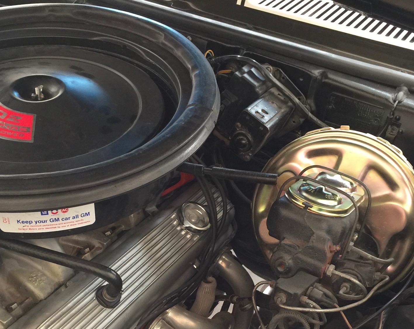

According to factory supplied engine wiring harness, is it supposed route over top of the wiper motor, or underneath it before it goes across the wiring tray?
Looks neat when it's under but want to make sure what is factory correct?

Over the top...Joe

I believe it should go over the wiper motor.
Here's a picture.
Ervin W
69 Z28 X33, Burnished Brown, Born with Drivetrain

Thanks Ervin. I looked at the assembly manual which also shows it over top, but wasn't sure as I have seen many reference pics with it running both under and over. I've also got the cowl wiring harness to run across to the hood and on most cars I see that routed underneath.
Thinking I'll run them both over to keep it consistent. Thanks for the replies.
