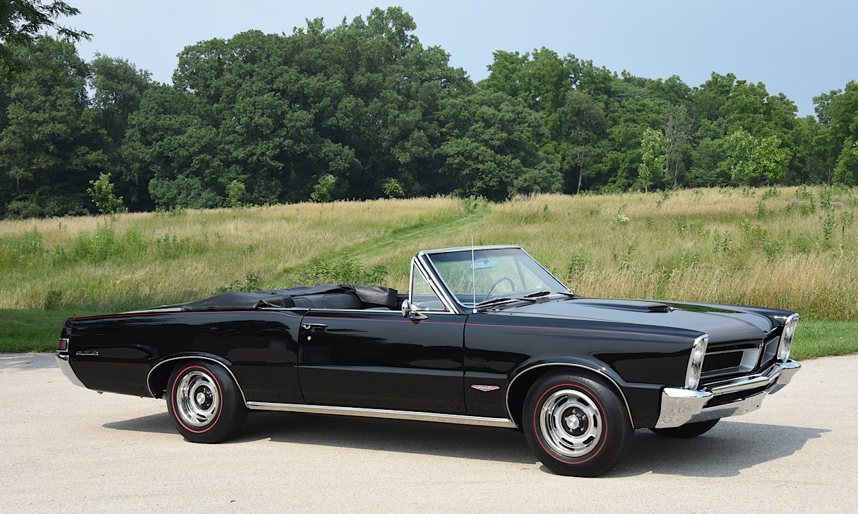

Gorgeous machine being sold by our very own Stefano...boy is this ever a clean car. I would love to see pre-resto photos and any owner history - must have been a special car since day 1.

Stefano- the only nits I would pick:
A). ‘66-‘68 Rally I centercaps, which look very nice
B). Valve covers are on backwards (pyramid should be to the rear on the driver side; to the front in the passenger side)
C). Instrument cluster bezel is missing the wood grain appliqué.
I have seen maybe two Kansas City built GTOs which appear to never have had the appliqué but I have never seen a Pontiac Michigan built car that didn’t have it originally.

Keith,trim on the brake and clutch?Tom

Yes - since it has power brakes (I didn't see power steering) it should have the chrome trim on the brake and clutch, to match the accelerator pedal.

No power steering and thanks for the tips.

Did you ever turn those valve covers ? J/K

No, I haven’t addressed anything yet.
