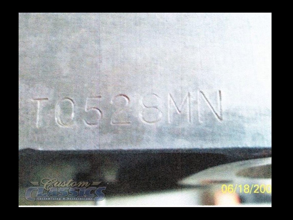

I believe this was Fred Eichorst's Barn Find COPO Camaro.
If so:
Note: There was NO original drivetrain and or COPO parts with the car other than a deep grove power steering pulley and big block engine stands. Drivetrain parts were sourced from J.M. No owner or dealer history and no documentation. The body was "extremely" rusty. It already had fenders, doors, and 1/4s replaced prior and both rear springs were sticking out through the trunk.

Subject VIN 124379N662520
Some info suggests transmission only may be original?

I'm not reading it that way, but all that is quoted also doesn't rule out an X11D80 SS 350 with cowl induction, as there was no BE rear.
The original firewall and tunnel proved the 4 speed status.
I believe that it is a real COPO Camaro. Some of the other clues when I inspected it was the Deep grove PS Pulley and the big block engine stands, Both bolt on items so still not conclusive. The Camaro had SS trim / emblems and was repainted a Garnet Red.
At that time the NICB came up blank and I could not find another COPO body number / order number close in the sequence.

How could trans be original if TT says 06A and listing says trans date is September ‘69? Am I the only one who is questioning the trans being original? Also, did anyone verify that any of the drivetrain components had original stamps? Nowhere did I read anything saying they were/weren’t. The car does look like a movie star.

He never states the transmission is the original,only that the engine & rearend are,so I read that as at least the case has been replaced by another.
Plus he says this in the ad..
The transmission was redone by Advantage transmission and as many of the original parts were saved and restored.

I don't see anything to indicate that the engine and rear are born with.
" It retains an original L72 427 engine, 512 block, original code BE rear end..."
I read that quote to mean the engine and rear were original COPO parts, but not original to this car. Gotta watch the word smithing.
And of course, the trans isn't original to this car.
