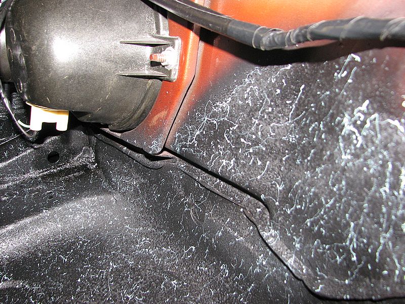

This is how the strings looked after spraying this 70 Camaro with the Berlage product. After a recent conversation with him he told me that the EPA forced them to reformulate it and it does not spray out as nice if you are wanting the stringy look.
