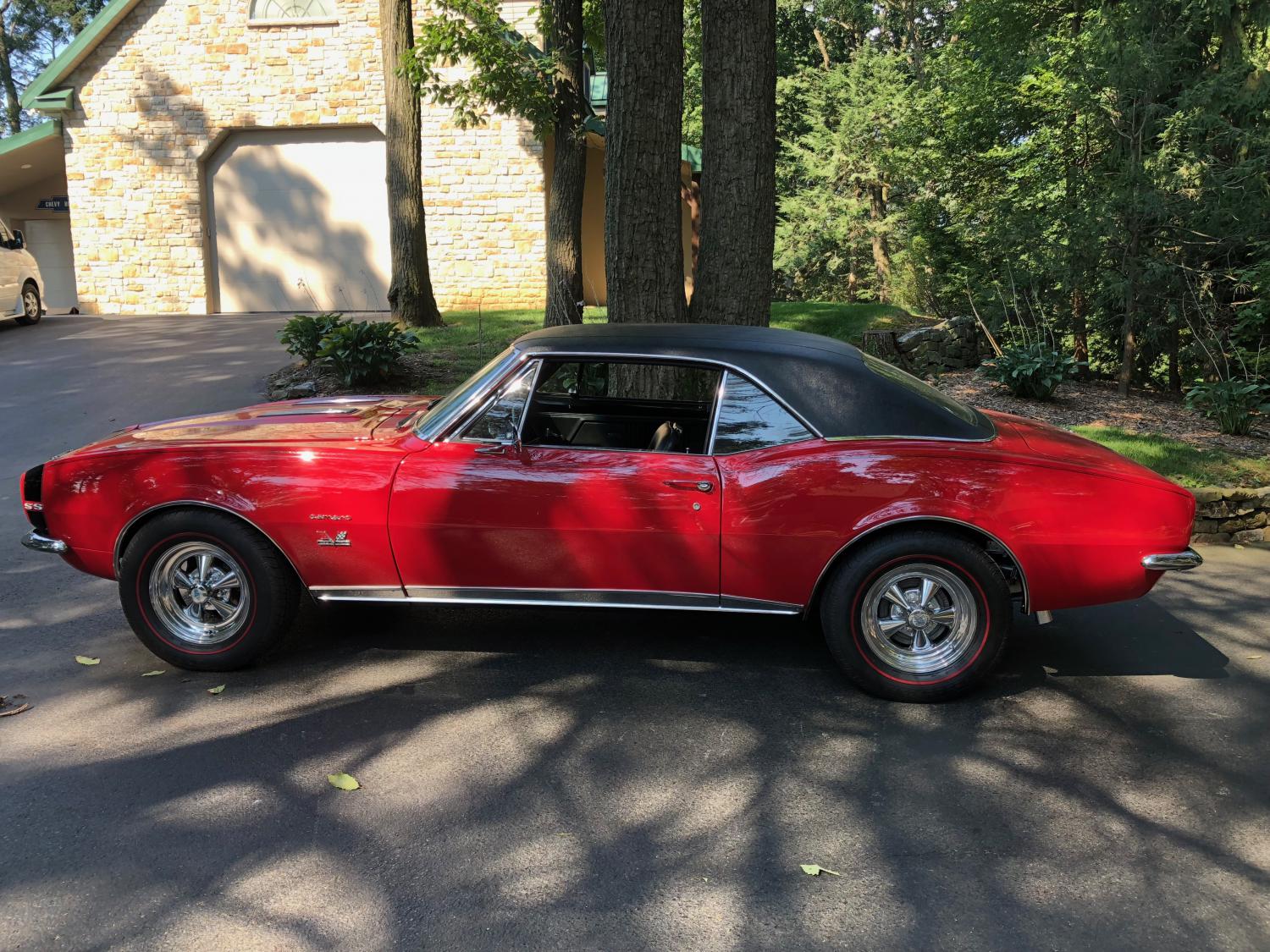

You can see I did the same thing on my 67. I have a 3/8" spacer. Combine that with longer wheel studs and mystery solved. All the bite you could ever want from your lug nuts. I had direct 5 on 4-3/4 spacers made by a machinist, you can find generic ones at auto parts stores and online but they just didn't sit right with me...

Those look nice Tony, much better than universals I found.... They look just like the ones I had made other than the extra holes.
