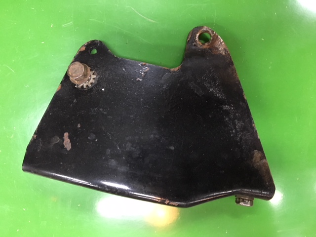

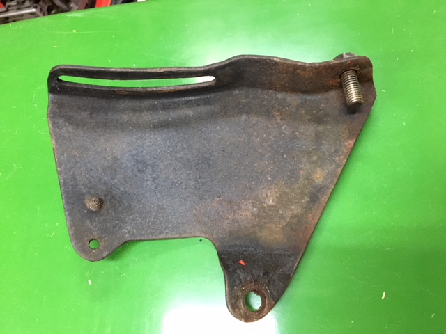

I'm in the process of trying to figure out what is correct/not correct on my 1969 Camaro COPO. Alternator brackets correct? What say the experts?

Upper correct, lower not for 69.
Then again, Your car being Sept 69, not sure? Could be both brackets are right?
In the last month I have looked at 2 early 70 SS Monte Carlos . Both were original documented September and October 69 cars. Both had 69 style upper bracket.

I agree that the lower should be a flat DSL piece, I've seen those on 1970 models too, with the round hole upper, so I think they (flat lowers) carried over to the 70 cars as well.
