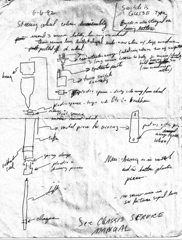

This helped me when I was putting mine together. It's not mine so I can't take credit for it. It is essential that all of those spacers are in correctly. It doesn't get tight until you put the steering wheel on. There is also a diagram in section 9 of the Chassis service manual if you have one.

I found part of that diagram on Team Chevelle a while ago. I don't have any of those spacers he talks about in that thread.
I recently bought a 1967 chassis service manual, but nothing in there for column.
I'll have to dig out my old Motors manuals and see if they have a breakdown.
Seems those spacers are unobtanium too. I may be experimenting with hardware store plastic washers and a slice of heater hose for that.
