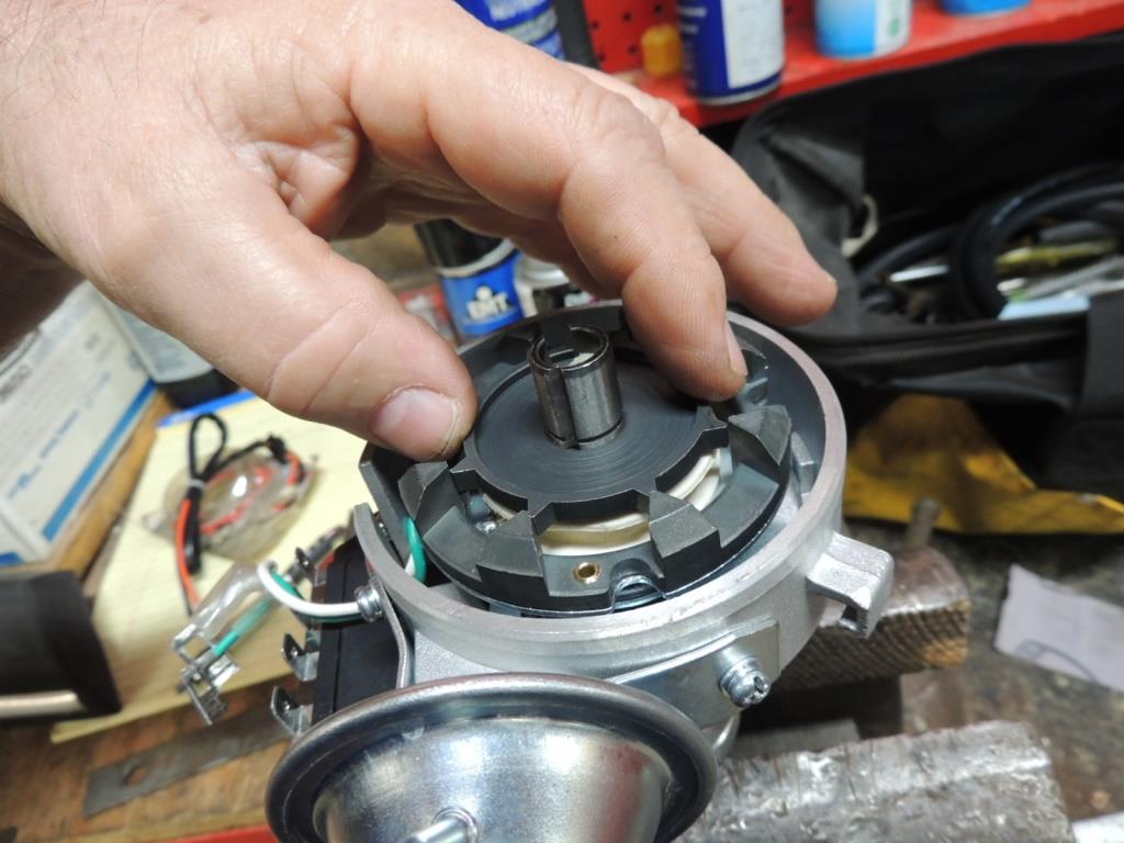

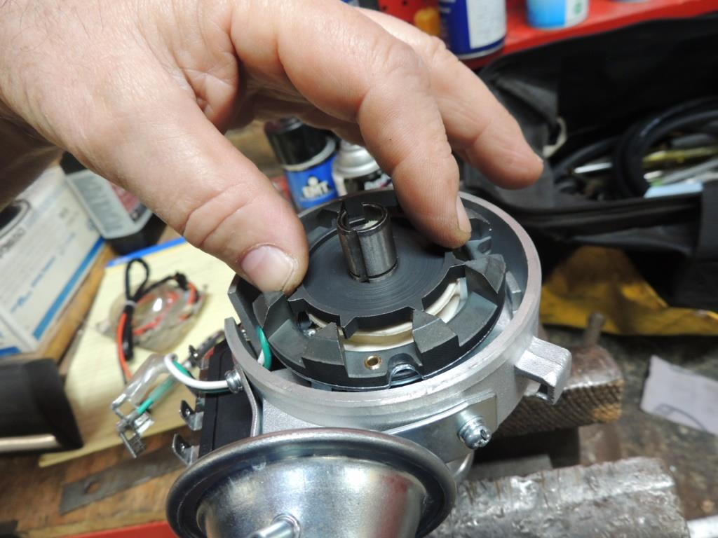

Got the distributor, and was very impressed with the machining of the body. Uses a GM type module. Very little slack up and down with the shaft. Put it on the distributor machine and for ran it at 500 rpm (which would be 1000 crank rpm if in the car). Started to increase the rpm and it started retarding the timing at 1000 rpm (2000 crank). Wait a minute, what did I do wrong? Nothing! Ran it multiple times and got the same result every time. It did finally start advancing, but not until 1200 or so, and then advanced so slowly, it did not reach full advance until 3000 distributor rpm (6000 at the crank). Totally unacceptable.
I thought maybe just remove one of the springs and see if it advanced a little quicker, but wanted to investigate the retard issue. I wasn't seeing things. Took it over the the bench and discovered that the reluctor wheel (if that is what you call it) turns a few degrees on the shaft. Even though they did a great job machining the body, they did not take the same care machining the groove in the shaft where the wheel sits. Pics attached. You can see how I am rotating the wheel, but the shaft does not move in those two pics.

I am sending the distributor back. It is a shame. Had they spent just a day sorting out the machining of the shaft (one groove) and working out a decent curve, this would have been a winner.
