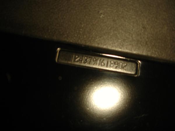

ZL1 #48
VIN 124379N618902

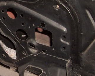

It is another long lost missing ZL1. It has never shown up on US title searches done decades ago by the guys who were seriously searching for these cars. It was in a body shop near Toronto a few years ago. I was told it had no trim tag and the body sheet metal dates were in the 24th week of '69 or so. I think this one needs some serious inspection.

I concur, I heard it had those issues. What was there to start with?
Interesting wording:
&quot;The VIN# designates this car to be #48 .....&quot;

This is the same &quot;third parter chatter&quot; and &quot;hearsay&quot; that led to the 5 ZL1 Camaros that were registered by one owner one the same day, the questionable yellow L89 Camaro, numerous rebody issue Copo cars, etc. all occurring in Canada. This car is not casually dismissed but seriously questioned because of its inspection by &quot;some guy in a body shop&quot;. I bet it was in more than one body shop so how is the source who has issues with the car owner the only one who may have seen the car? At issue is the car itself. We hope is a real rare car, that just has not always been the case with some of the rare Canadian cars appearing in recent years with no real histories at all.
It all comes down to due diligence; if the body has March/earlier '69 not June '69 dates, the trim tag is real, etc. then this will be just idle chatter. Any prospective buyer will want to verify the true condition of the # 48 ZL1 Camaro in question with a qualified inspection. That is the only way to end all the idle chatter and set the facts straight.
