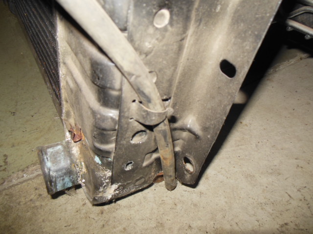

What is the correct routing for the overflow hose on a s/b

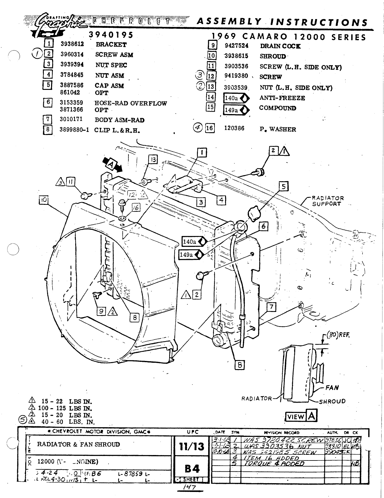

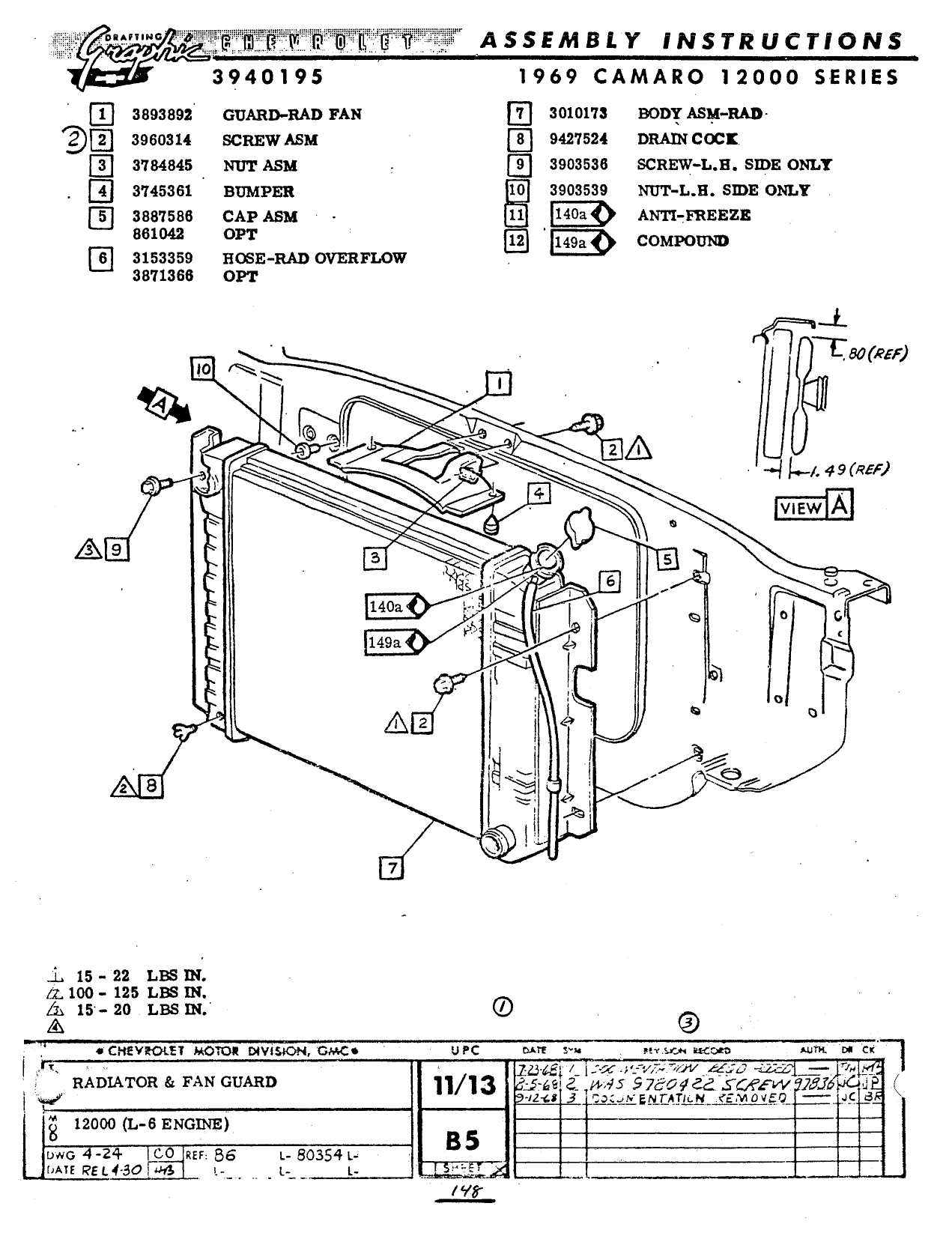

Does this help?

That looks like the 6 cylinder assembly is there a v8 page ?

Yes sir. Same routing.

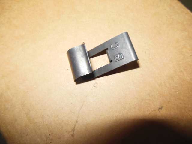

Great thanks i wonder what the other clip is used for all the parts places list it as the overflow hose clip ?
