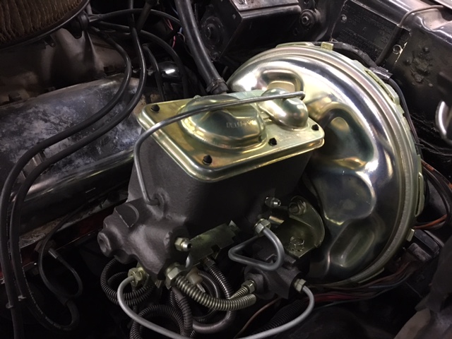

Hoping for some help, Looking to find out the correct information for Power Booster. I have a 9204, my question is where the Delco Moraine is stamped on the cover. Is it to be located on the top right rightside up? or on the bottom left wording upside down under the check valve? Hoping to get experts on this

You got your left and right mixed up? All references of L&R on a car are to be made from sitting in the driver seat. To answer your original question, upside down on right (under check valve) or closest to engine.

My Car is late 68 (12B) on the build date, I was looking into buying one with a Julian Date between 310-330. I have found one with that date code 325 but the stamping is is in the 2:00 position with upright stamping.
The 9204 was used starting mid year of 68 so I think the date code is correct.
I have read that may cars have the upside down stamps boosters, some did not have the Delco Moraine stamping, and some "got it right".
Not sure if there are any Camaro/Nova guys out there that may have it in the 2:00 position?

My feb built nova has it’s upside down DM stamp under the check valve. Go to brakeboosters.com he has a few pics of real ones.

From my 70 L78 Nova
DM upside down
082
