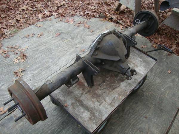

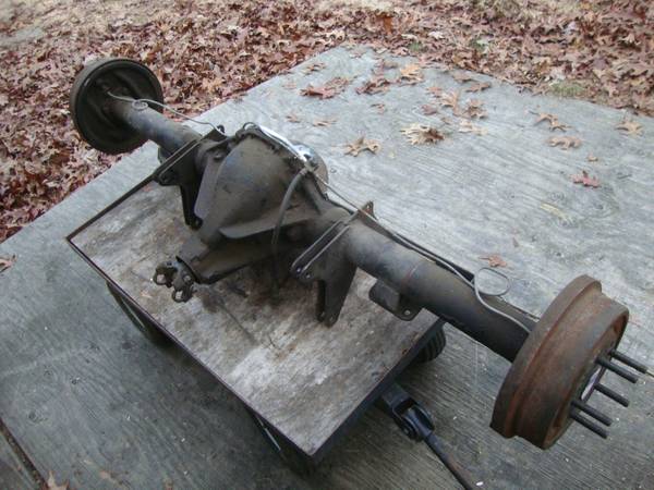

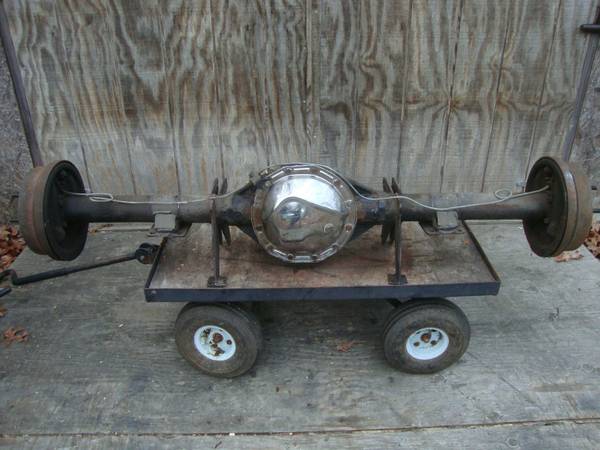

looks pretty bad to me you can be the judge
https://southjersey.craigslist.org/pts/6068741507.html
69 RS/Z 302 VE3 Daytona
69 Chevelle SS 396 375
69 T/A clone LS6/6 speed
90 Formula 350
Attachments - The Supercar Registry image.jpg coporear01515_8sH9Cm8wFuU_600x450.jpg coporear00U0U_17JbU0TgeIq_600x450.jpg coporear00m0m_45sclwgMeEU_600x450.jpg
Old 04-18-2017, 05:23 PM
Posts: 20,963
Thanked 3,607 Times in 1,456 Posts
Printed for posterity.

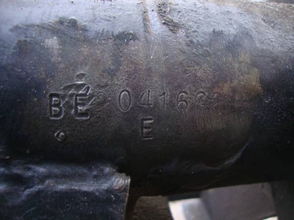

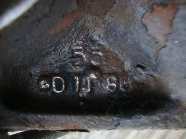

Original 69 Chevrolet Camaro 427 COPO 12 bolt rear end. This is an original BE rear end that was in a race car for many years. Currently has 4.56 gears with spool, Moser axles, and c-clip eliminators. Casting date is D-11-9. Assembly date is BE 0416G2. Will need original spring pads installed and ladder bar brackets cut off to go back into an original car. This is a must have for any original COPO or Yenko 427 car. $5500. 609-320-8025 Matt. No texts.

It's common to see the marks in the area where the axle code is but, I wouldn't think the BE would still be so clean... Looks like a bad re-stamp to me. Not even similar fonts to an original axle code.

I am very skeptical.

Sorry, not "buying" it...

I don't have any BE rears with that date. I do have BL rears with that date though.

looks like D 11 9 cast date. are you saying that it was a BV or it's a '68 BE?
