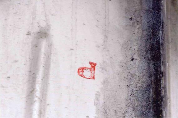

Just taking apart this 67 4K car and noticed the "B" inspection stamp on the firewall. I generally see these prominently stamped on both sides of the firewall during restoration. This original is stamped under the fender.

Bruce very common to see this on 67 Camaro, on Grady's red car we found 3 on the driver side.

Yup, my 67 had all three on both sides. Can't see them once it's back together!

They were scattered on my 1967 along the tulip panel. Here is the P

The T stamp on my gold Z was up high near the A pillar.
