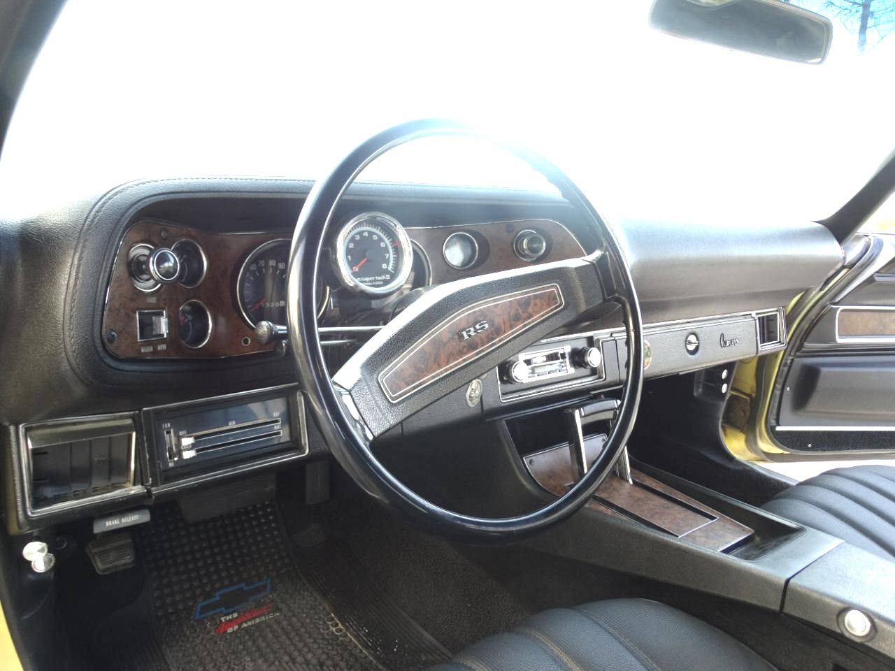

This one on ebay? Price seems low, wonder why. I see the accelerator pedal isnt mounted to the floor. No pic of the trim tag. HMMMM

You can see the floor mounted pedal in their ad online. I thought the price was "reasonable" too which is why I am curious about the car and the dealership.

I went to their website and the car definitely DOES NOT have the floor mounted gas pedal which ALL 1970 Z28's had. I'd be careful of this one.

first pic is a correct 1970 Z28 gas pedal Second pic is the gas pedal of the car at Gateway classics

The website shows the TT and some underhood pictures. No picture of rear so hard to tell if it's a 12-bolt. It's missing the rear sway bar, and of course the Z-28 only gas pedal. Looks like it has a single 3/8 fuel line.
