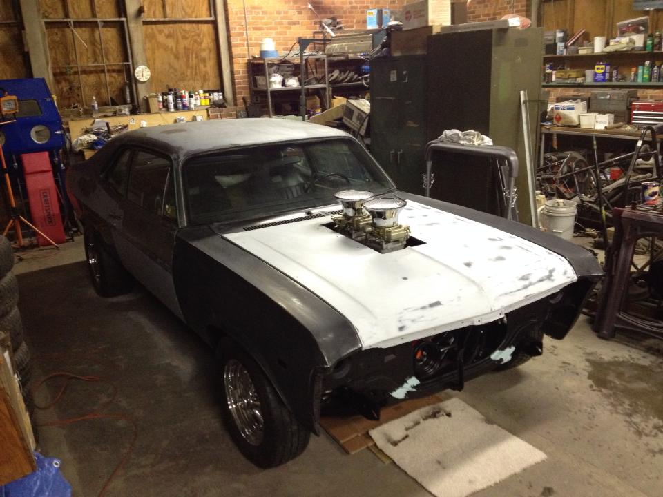

Who has the best radiator for a BBC in a '69 Nova? I have 2 radiators, and neither of them fit....

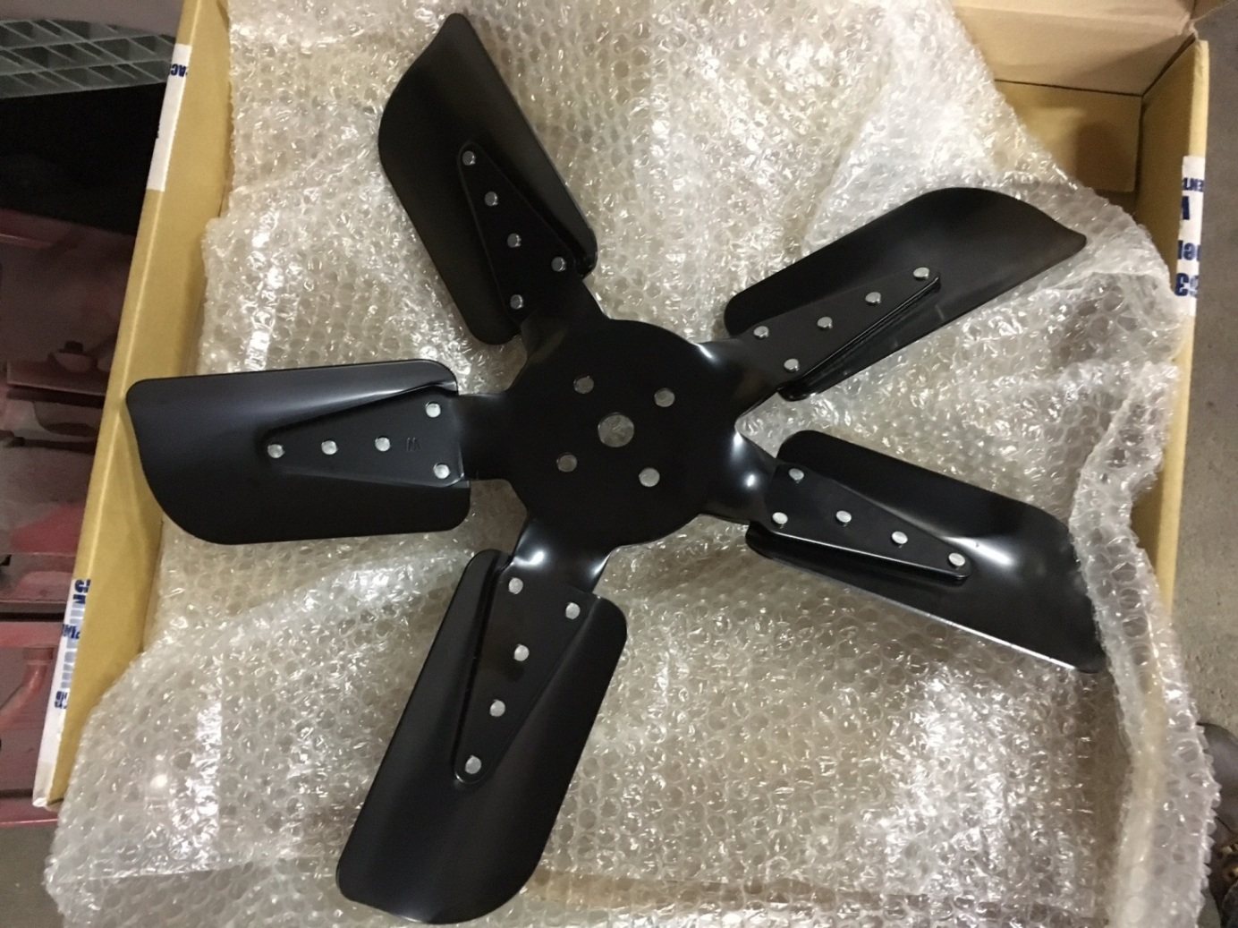

Anyone ever use the repro 5 blade fan? I don't want to spend the money if it's junk, I can just put a flex fan on it for now but I gotta get the 1" fan spacer.... Earl's got one on EBaY!!

I purchased a repro 5 blade recently... works fine... no spacer. It's a tight fit with a 4 core (re-cored) original Camaro BB rad !! also close on the rear side to the alternator pulley.
I do not have an original for comparison but this piece looks pretty good.

Marlin, i also bought a repop fan and it works fine. No spacer...

Repro fan arrived yesterday, will trial fit tonight - sure looks nice, even has the 'W' stamped on it. Wonder how close they are to the originals?
