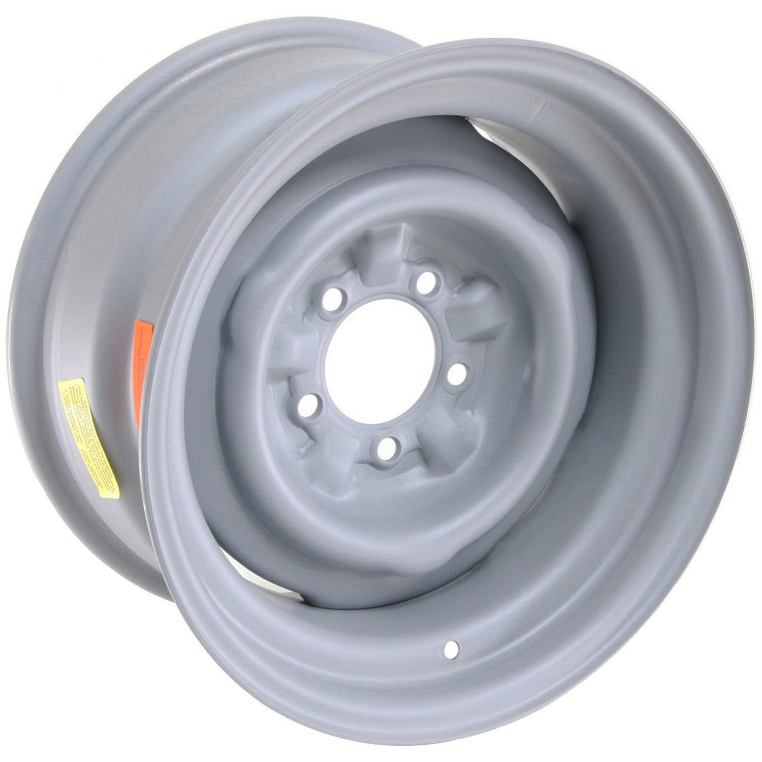

I want to put a set of slicks on my 69 chevelle to do a few passes this summer any recommendations on size am I on the right track for the correct day 2 look.
https://www.cokertire.com/tires/styl...ck-900-15.html
http://www.ss396.com/part/NSK-68157.html

do you know what back spacing

I probably would use a 15x7 with a 4 or 4 1/4 backspace. Should have plenty of room.

As luck would have it, the Vintique wheels listed here ( http://www.jegs.com/i/Wheel-Vintique...34044/10002/-1 ) are 15x7" and have a 4 1/4 backspace.

I bought a pair of the repro steel wheels a few years back. I did not notice that the center hole is over sized on the repro until I mounted the tires and put them on the car. It did not look right to me.
