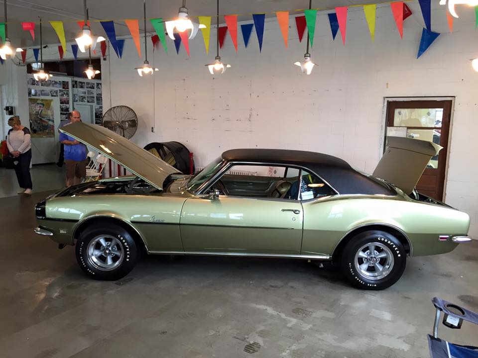

I've used both Dupont lacquer and Sherwin Williams base/clear. Hands down Sherwin was best. Dead on in color as well. First mix and spray out matched my cowl sides perfect. It is NOT an easy color to spray. The color flips and flops depending on the light....Goes from mint to olive & gold to green. Love it!

Thank you. The mix was done at the Body shop with there system, Danny used the default mix ratio for the color. He was all paronoid after just respraying a Butterscotch RR multiple times to get the shade right. I told him to follow the "book" and due a spray out. The match was perfect. I like to say there's more green than gold. We jammed mine first, then rehung all the metal to keep the spray out consistant. Took a bit longer, but with the crazt tint and metallic, we didn't want anything noticable.
