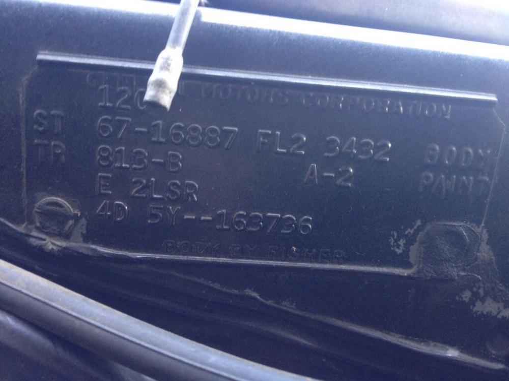

Looks like a deck, but stamp looks legit, or am I missing something?

Rich, I'm not an Impala expert so I cannot add value on the stamp per say but the quality is so poor, I don't think an expert would be able to help... I'd start but requesting non-blurry photos of the pad without paint on it.

Thanks, I did ask.

That doesn't look original to me.

"That's about as good a picture as I can get. Sorry, but I am not willing to remove the paint. Block was not decked. Trim tag was never removed. Thanks for the inquiry."

i like the trim tag. the engine stamp pic is not good enough to tell. The IJ sticks out, could be the photo. And the scratches on the block surface just looks like coarse sand paper, not circular as when the head surface is machined.

the 4D looks to close to the other characters?

Those do not look like original rivets. Originals were punched through and spread out.
Those look like the replacements that have never been punched.

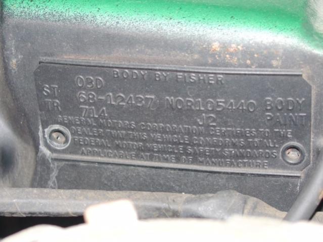

Here is a for sure real ss427 trim tag
