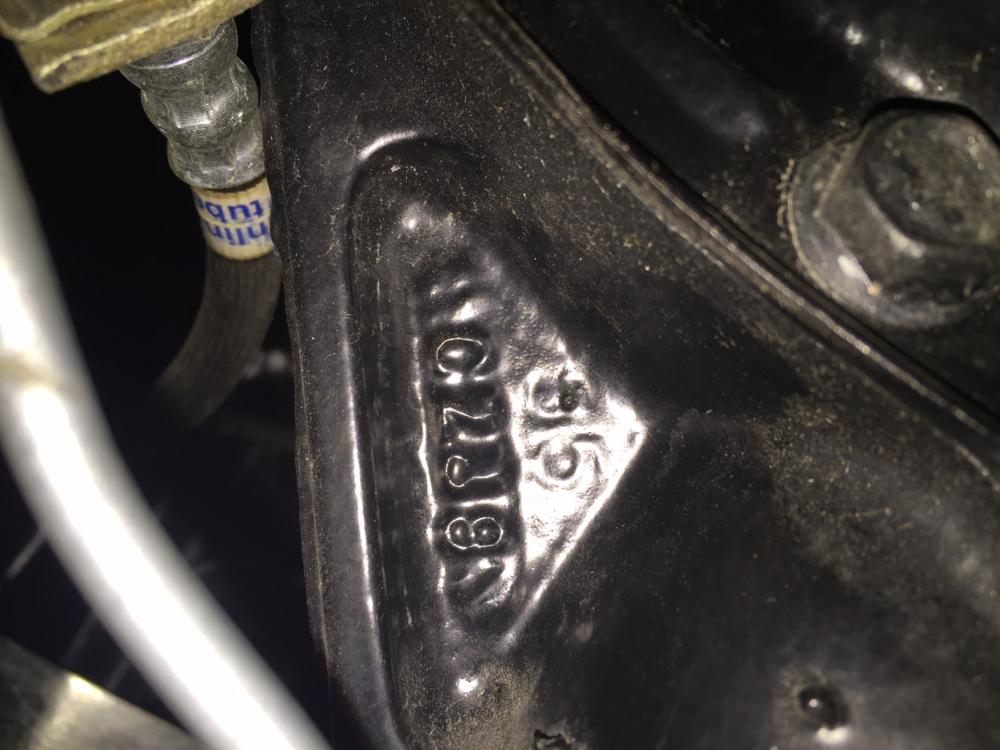

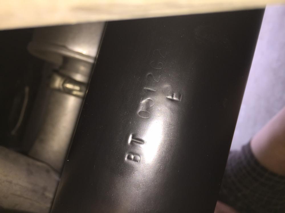

Does this stamp look correct? Car built second week of July 1968

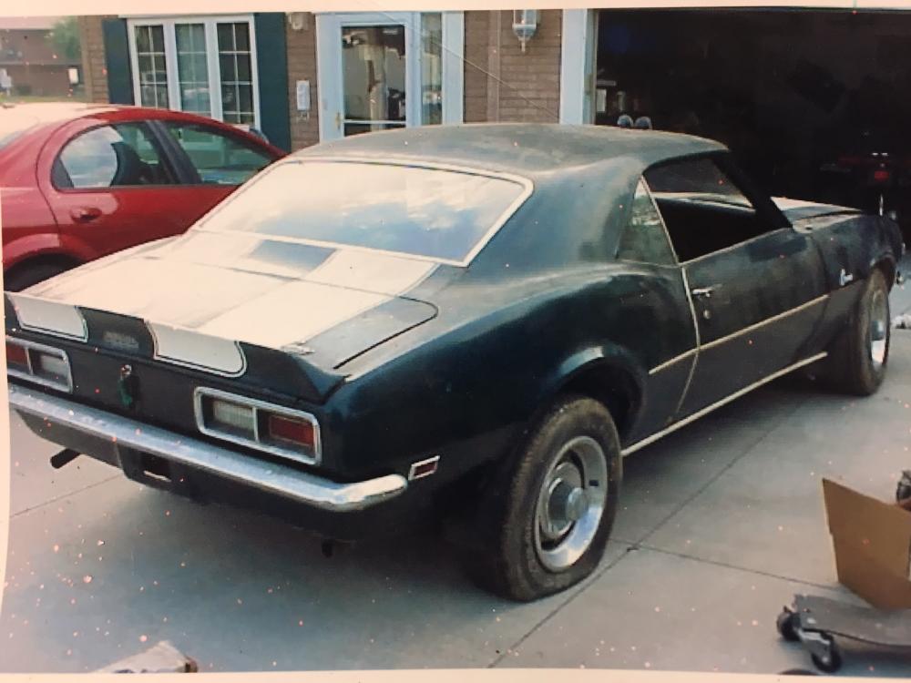

Prior to restoration
