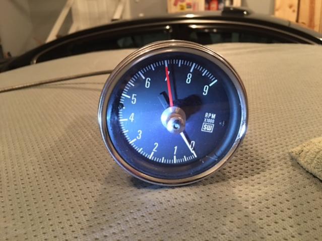

how are you mounting the tach on the dash? mine hits the windshield in orig gold bracket, might have to make a short plate to bolt to dash then bolt tach bracket to that? ideas?

Mount it to the dash face like Yenko did.
I have a cable drive tach I plan to use on a 68 Z in the future and I plan on mounting it on the dash face or column. I just have to figure out a mount as mine does not have one..

were those sw tachs cable drive?

The ones Yenko used were electronic. The one I have is cable.
