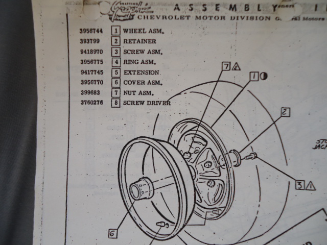

Another question I have about these wheels....
What type fasteners are OEM correct for attaching the "SS" center caps? Phillips head screws, hex head cap screws, or???? Is there supposed to be any type of washer under the screw head, i.e. flat, lock, or both?

I've only seen 2 Hex bolts used with no washers needed behind the retainer,originally.Obviously this is for the bolt on caps,and not the spring steel retained clip on caps used during most of the '70 production.
Becareful to not over tighten with the socket,as those pot metal threads can be stripped quite easily,especially after the cap has been re-plated and the acid weakens them.
1970 Chevelle Assembly manual..

I believe the correct fastener for '69 is a large pan-head screw. It also had either a lock washer or captured external tooth star washer. I can check for sure on Sunday to be sure.
Incidentally, the gent that worked in the Baltimore factory told me that during the 69 production year, Chevrolet started including wooden-handled phillips screw drivers with the jack assembly so the customer could take off the SS cap with a tire change and be able to re-secure the wheel in the trunk. I don't know if all the factories did the same or not.

Rick, it's interesting that the 70 assembly manual has the components of that wheel illustrated, whereas the 69 manual does not.
