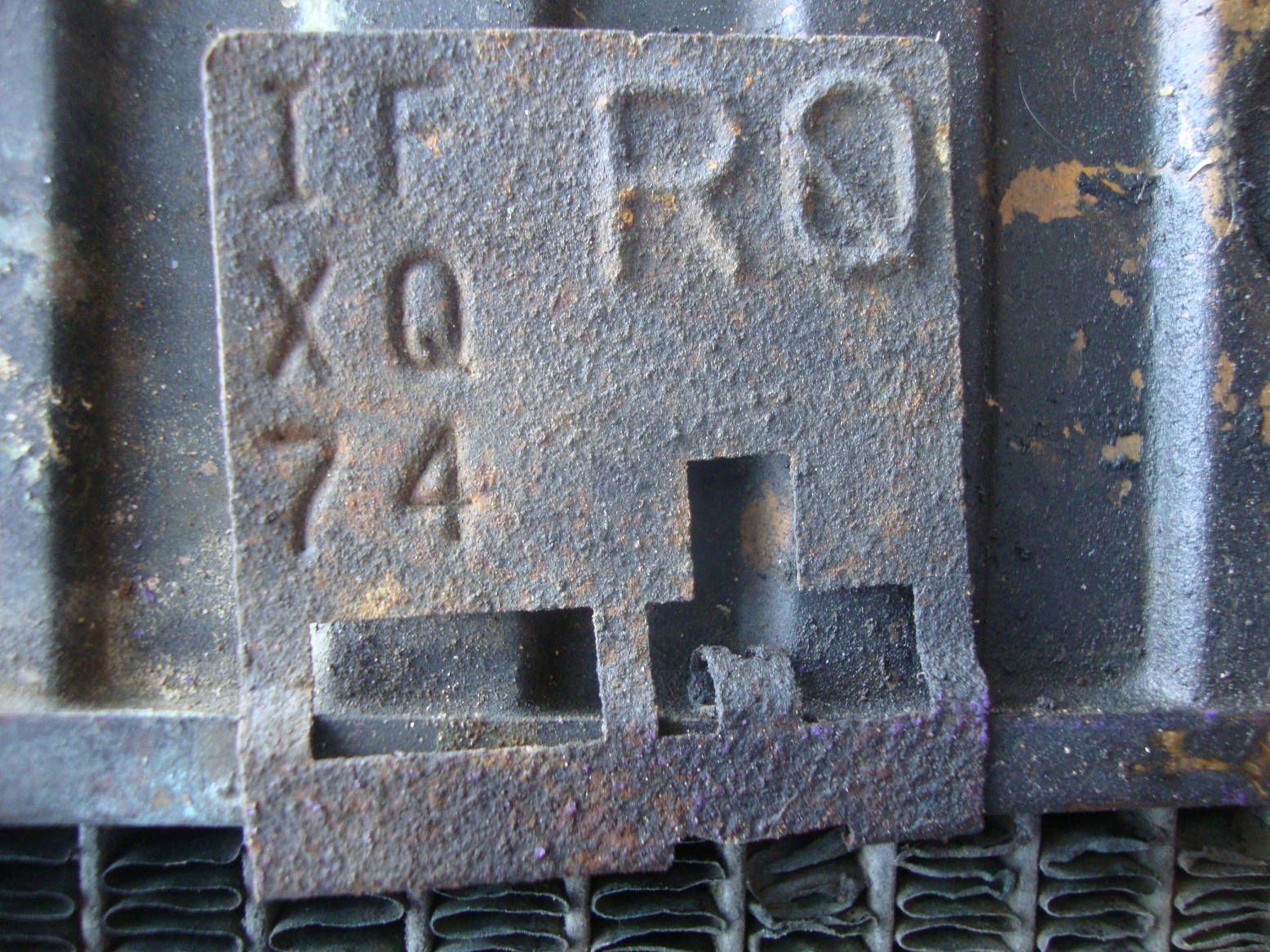

Any ideas on what this one is? IF XQ tanks with an RO code.

Pretty sure it's a truck rad.
What's the numbers on the bottom edge of the tag? Good time for Evaporust....

That is a Chevrolet Truck radiator & with the IF drivers side 4 row tank..I've seen the XQ pass.tank before,but can't recall where.
It is late 1960's/early '70's vintage though,seeing that the filler neck tank is slightly angled and not as extreme as the years '71 & after.
Part# looks completely corroded.
1970 SS Chevelle/Elco Manual Trans. 4 row used XJ pass.

I think it's 69 truck, but the part # will confirm.

I'll see if I can get the part number to show. thanks for the ID help.
