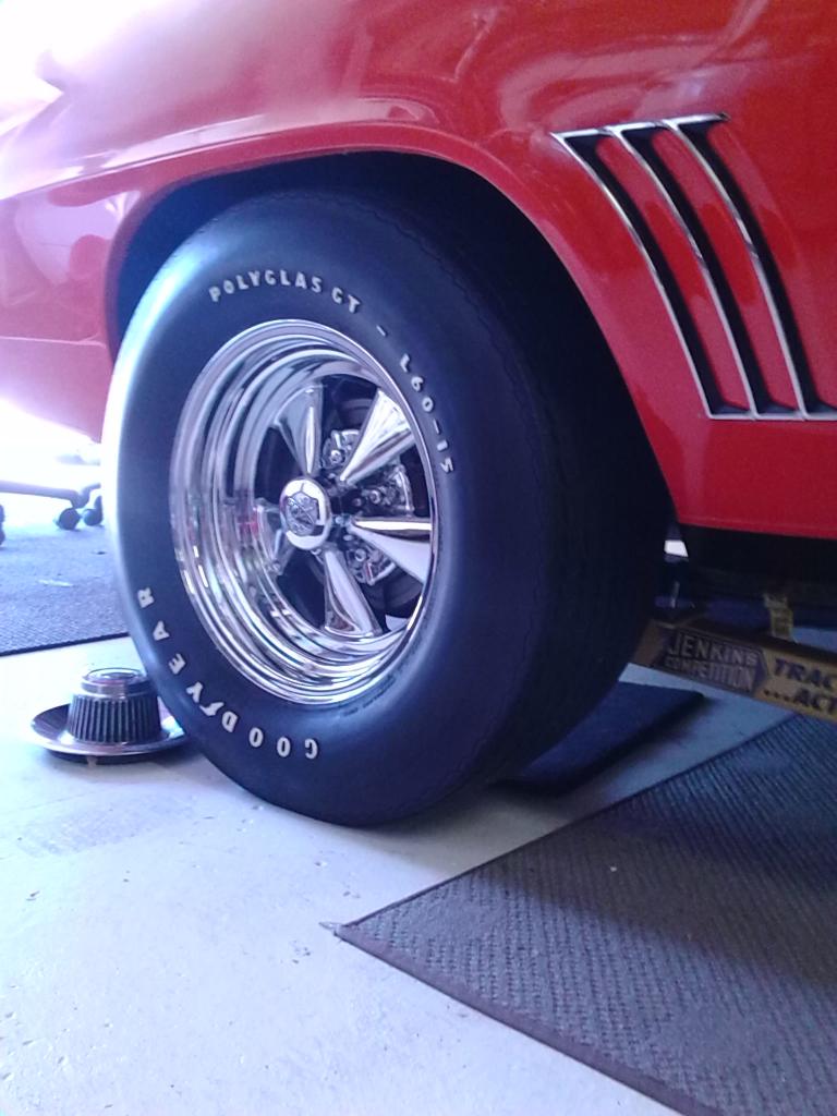

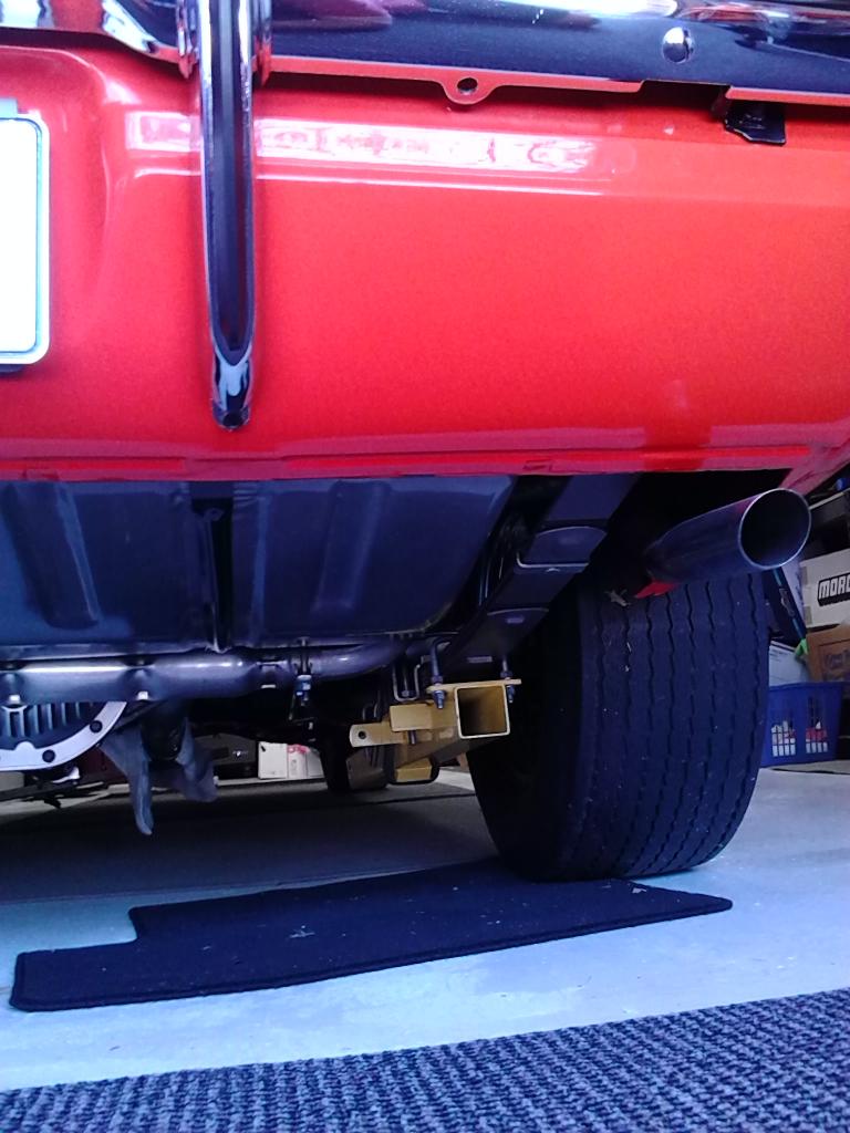

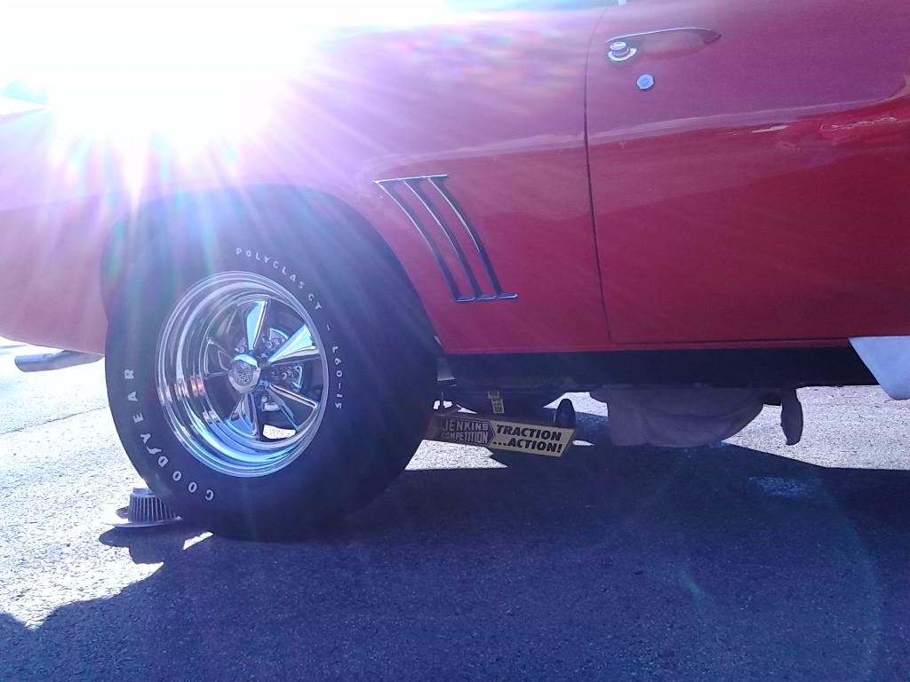

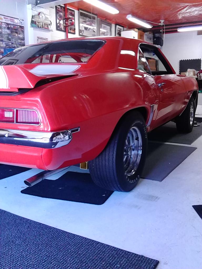

Not Exactly what pics you've requested....
Here is 10 inch wide rubber x 27 inches on
8 inch wheel with deep back space ....uncut sheet metal..on a 69 Body . 70's have a much bigger opening for a larger diameter tire with more room for width.

Default Re: Pics of 15x7 reversed dish cragar with slicks!
OMG -- using a rally cap as a chock? ... LOL
Tom, I like your wheel chock... [img]<<GRAEMLIN_URL>>/biggthumpup.gif[/img]
