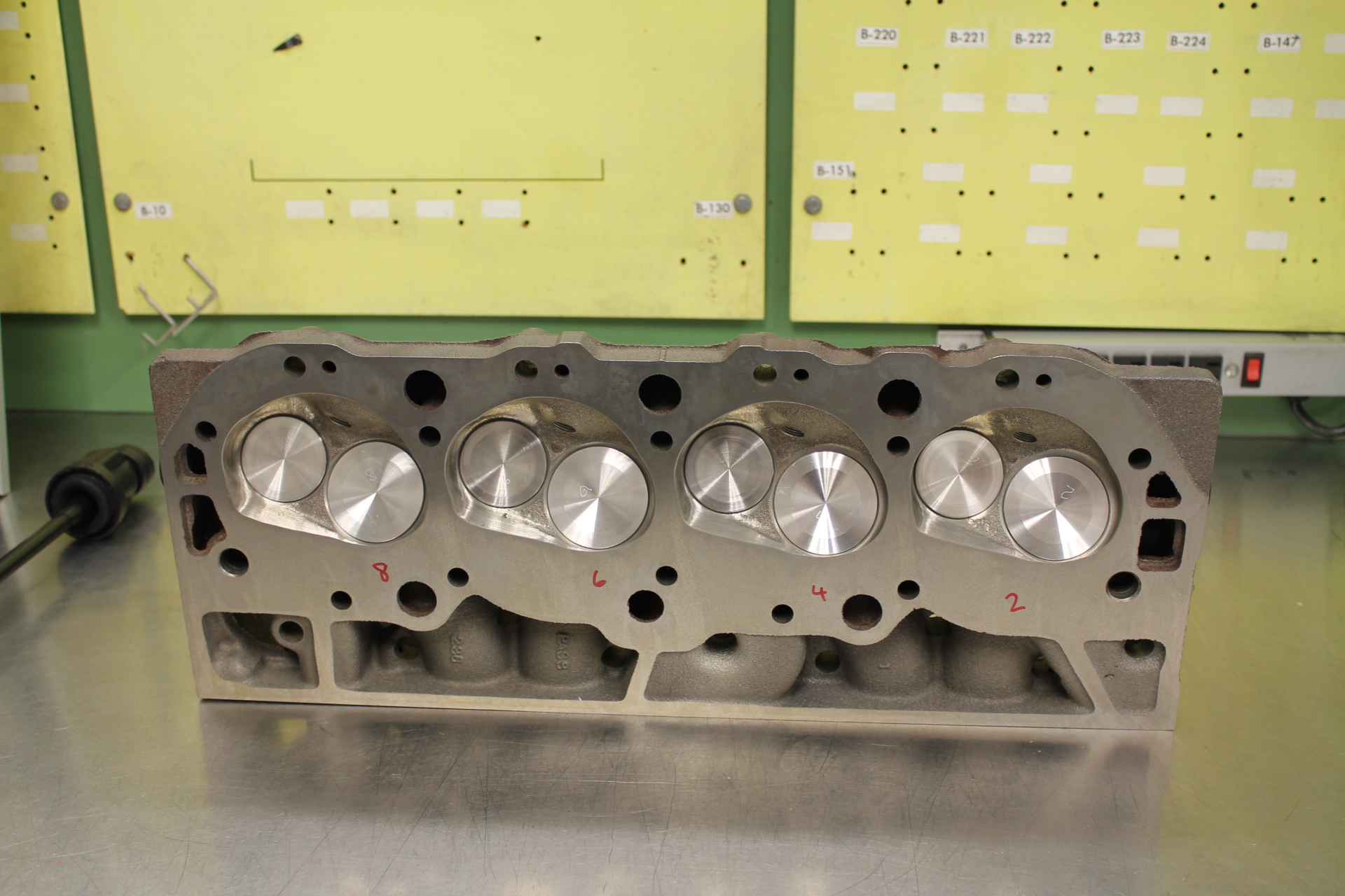

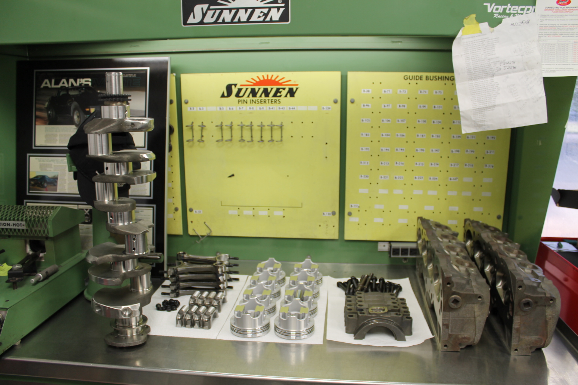

My goal was to build a smooth idle 9.3 compression 467 BBC with peanut port heads (236 castings) then put it in my 1968 Chevelle for a drag test, yes a real drag test. Some pictures as the build went along. The center piece of my build, notice the symbol.........that sure isn't a hump there!

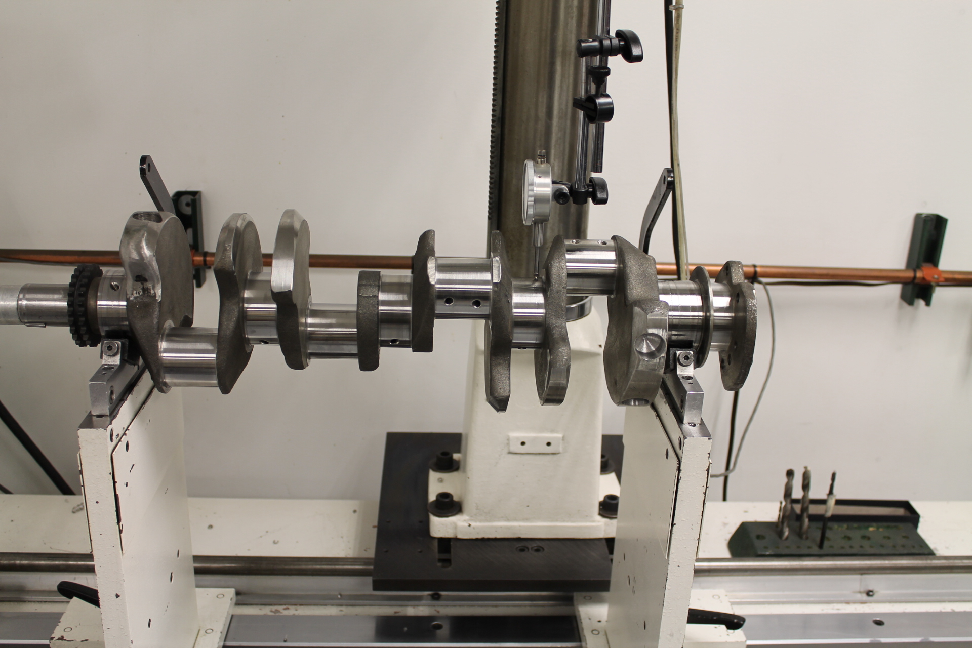

Some more pictures of the completed rods, GM 3/8 press fit. The 236 peanut port heads assembled.

Any pics of the finished intake ports?
Just curious--have you ever tried working a set of "820" heads? They have a relief cast in the chamber by the exhaust valve similar to yours
(pic snagged from the internet)

Yes, I have used them, Its actually a similiar chamber as a 215 or 063 or 290 with that cut out behind the valve.

<div class="ubbcode-block"><div class="ubbcode-header">Originally Posted By: Vortecpro</div><div class="ubbcode-body">Yes, I have used them, Its actually a similiar chamber as a 215 or 063 or 290 with that cut out behind the valve.</div></div>
I've used the 063s -- made good power for a first half-a$$ed open chamber design ... FWIW I am still running these heads with porting similar to Sissel (spell) mods ... TAZ

I should clear something up -- the 063s are NOT peanut port. Peanut port heads are normally found on truck engines to build goobs of low RPM Torque. 063s have larger oval ports. TAZ

Heres you go Anders.... more pictures, the crank GM 7416

Those look like the '69 '148' chambers.
Does anyone know the chamber size of stock '148' heads? I've seen a lot of conflicting info.
