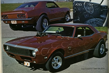

Finally put my wheels up for sale on my Camaro (16" AR TT's) and have a few guys interested so I need to pull the trigger on some new 15" Cragars so I need some help. I want to go 14x7 fronts and 15x10 rears but wasn't sure what offset will be acceptable with either 295/50/R15's or 325/50/R15's?
Would a 4.5" offset be OK? Obviously with the 15x10's I want the deep dish look but I'd rather not have the tires sticking way, way out (some is OK, but I don't want them way out there).
Anyone have any advice for me? Thanks.

14x10 and the backspacing is 3.75" I would bet 4.5 would rub but I might be wrong.

4.50 will rub the springs if you run large size tires. My rims are 3.75 BS and the tires are about 1/4- 5/8 away from the springs

Fravel Camaro 14 x6 front and 15x10 rear identical to my rims backspacing and all.
Mark you need to run vintage bias plys on your car

Fravel camaro 14 x6 and 15 x10 3.75 BS

I can't wait to see it with the "right" wheels. Also, another vote for bias plies! Radials would be a disservice to it IMO. Especially since you can find Pro Trac N50-15s, and I believe Kelsey tires make 14 inch Goodyears.
